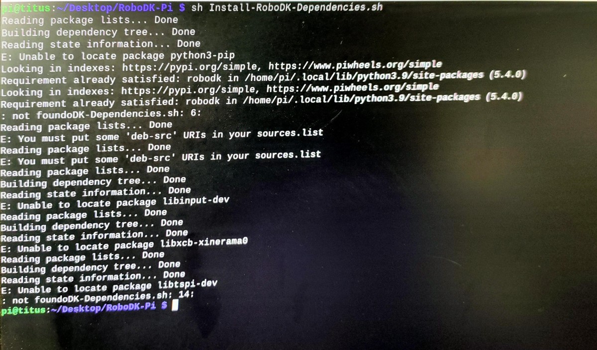

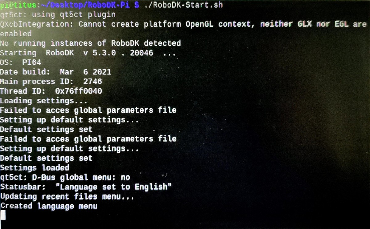

I have been trying to install and run RoboDK on a Raspberry Pi for the last few days with zero success.
I have been following the instructions in the instructions file but keep getting displayed the following messages after attempting to install dependencies and then running the program itself. I've tried installing the missing dependency packages manually but to no avail. They are reported missing again. Some help and guidance would be greatly appreciated. It doesn't seem like many people have openly documented their use of this program yet.
I'd really like to use this software on the Raspberry Pi.
Kind regards,
Rowan
