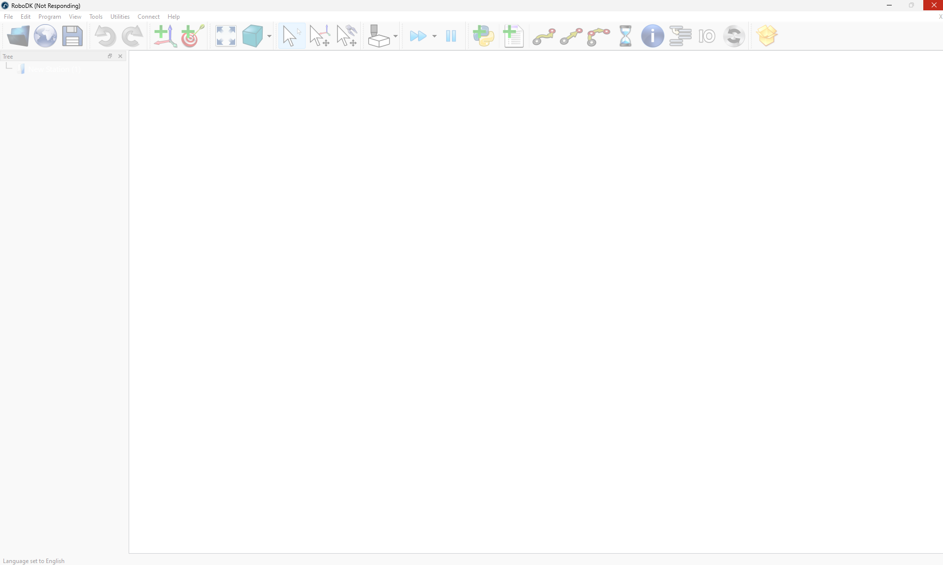

I installed RoboDK and it starts perfectly only the first time when starting directly from installing wizard. After that, it never starts, it immediately goes to not responding. I tried uninstalling and installing multiple times. Only when started automatically from wizard it doesn't crash. Every other time, it is not responding.

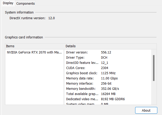

I updated graphics card driver to newest.

I tried running RoboDK-Safe-Start.bat - same result - not responding immediately.
Only difference between running Safe-Start is status bar says  "Loaded 2 plugins", and when running normally status bar says Statusbar:  "Loaded 0 plugins". Then both versions go to not responding.
I use Windows 11 and NVIDIA GeForce RTX2070 MaxQ. I don't think it is graphic driver related as it runs from wizard just fine, but I cannot run it any other time.

Did you change any settings the first time you were able to successfully start RoboDK?
I recommend you to start RoboDK again using the default settings.
If you are unable to use the software because it is unresponsive, one option to recover the default settings is to follow these steps:
  1. Close RoboDK
  2. Run this file by double clicking on it: C:/RoboDK/RoboDK-Set-Defaults.bat
  3. Start RoboDK again
