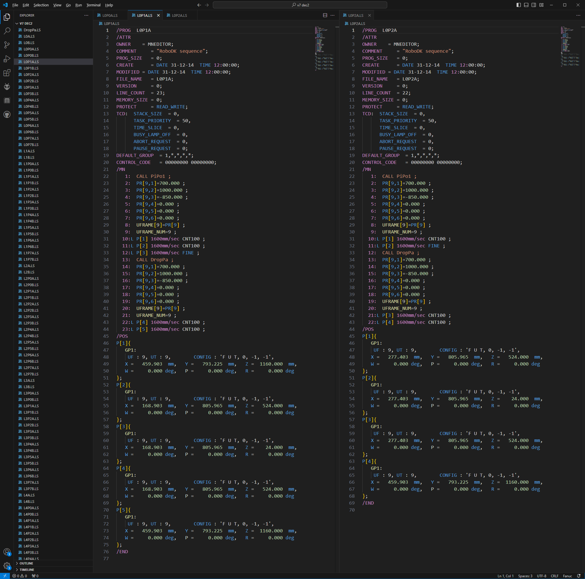

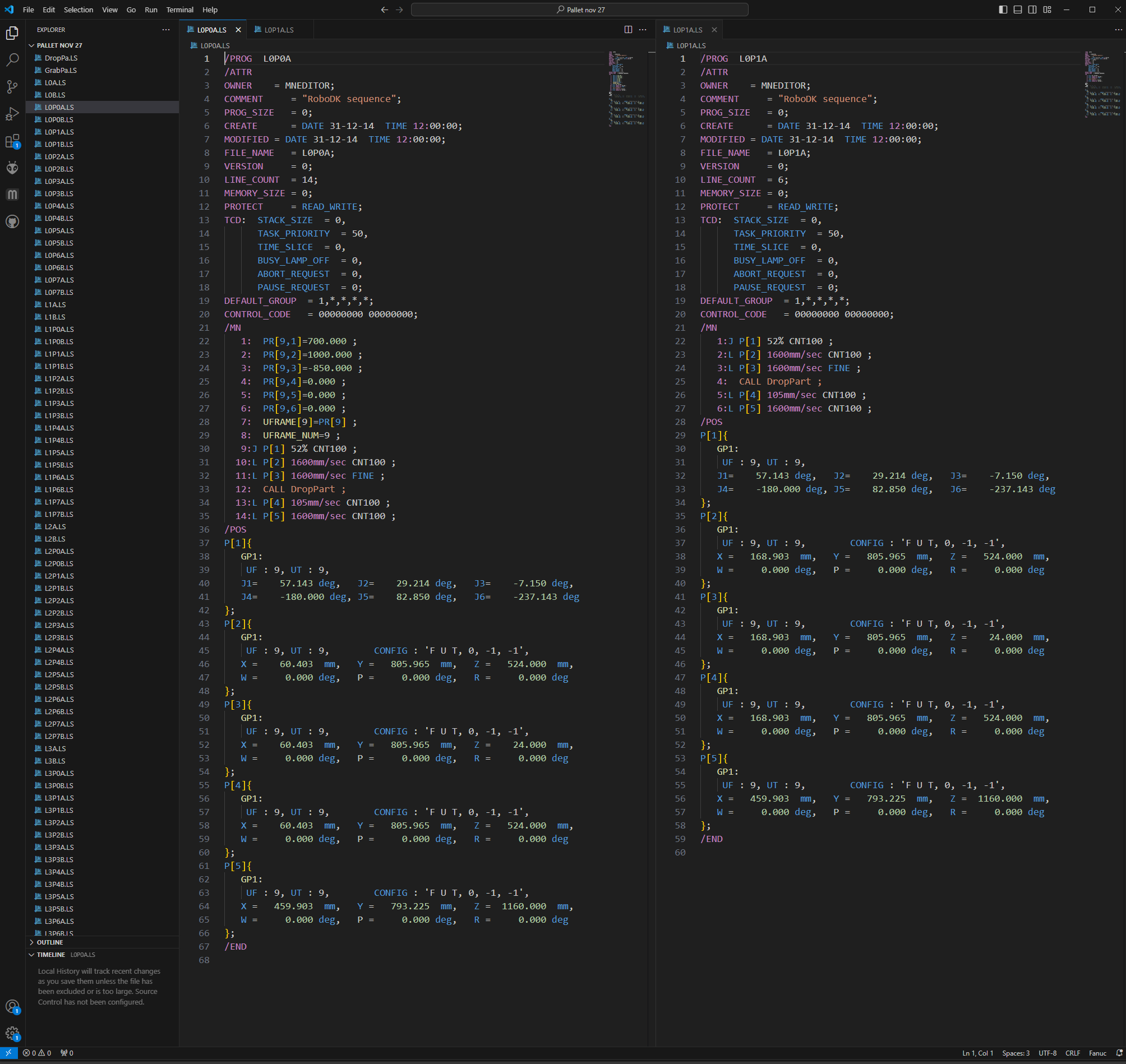

I'm trying to use the palletizing plugin to create sub-programs for a part stacking operation. Ultimately I plan to use a KAREL file to call these programs.

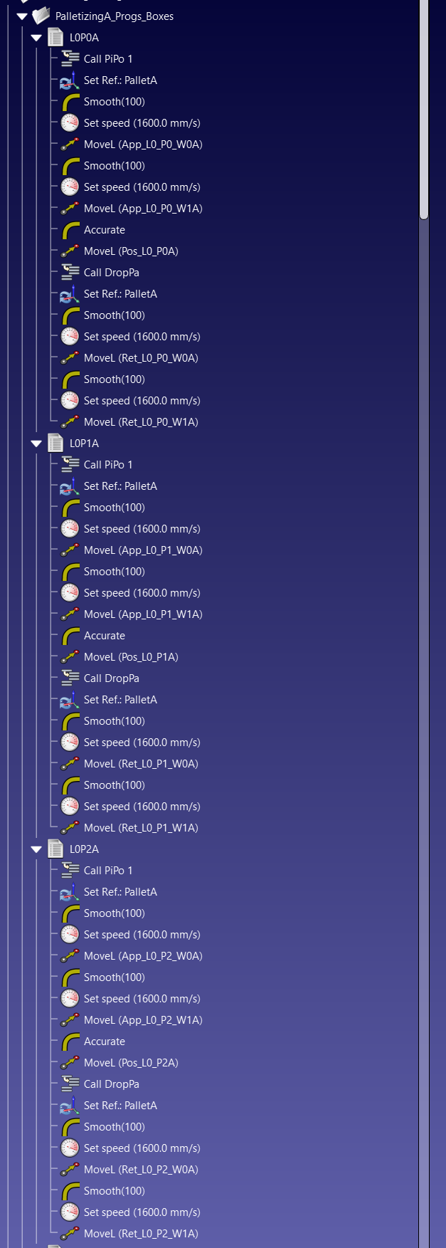

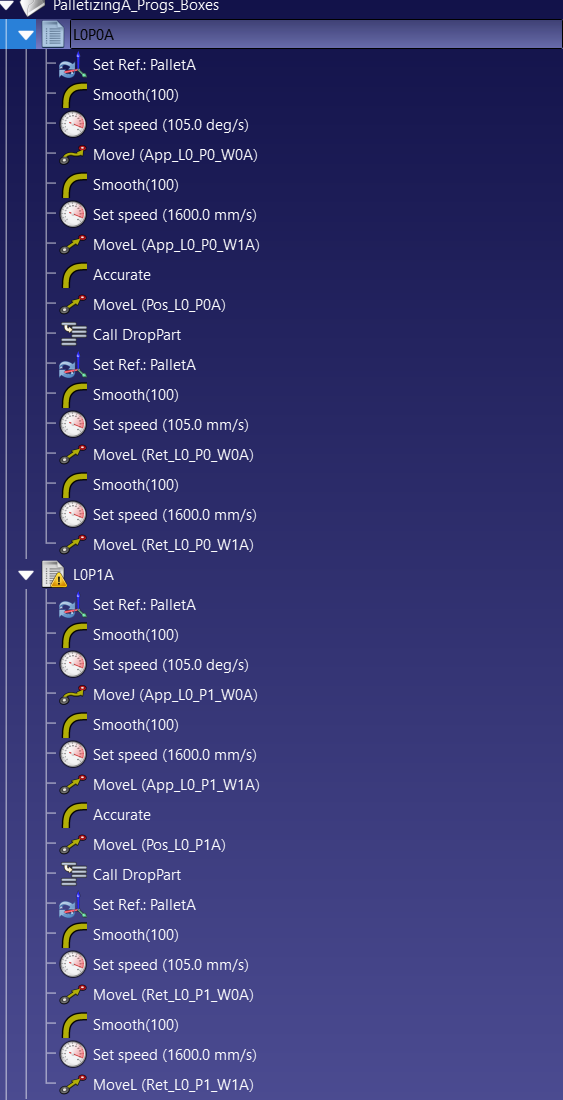

The problem is that the frame isn't defined in most of the programs when I export them. The frame is only defined in the first and sometimes second part drop program. From what I can tell the frame reference is set in all programs and the .LS files should all contain the frame definition. I've attached a screen grab of both roboDK and the .LS files for the first two drop programs.
I've read that the post processor might be removing repetitive frame definitions and I've taken a look at that but I didn't see anything obvious...
I'd like to be able to use multiple frames to define the pickup table and the pallets. Thus needing to switch between the pick table frame and the pallet frame for every step.
