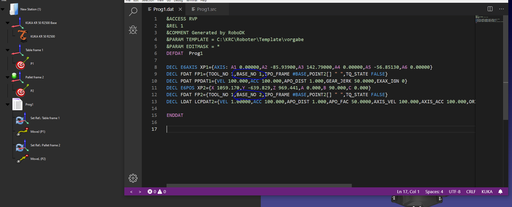

Now also with screen dump of the .src file...
Yes, this feature existed for a few years now.
