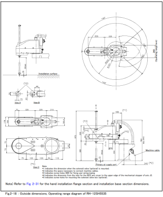

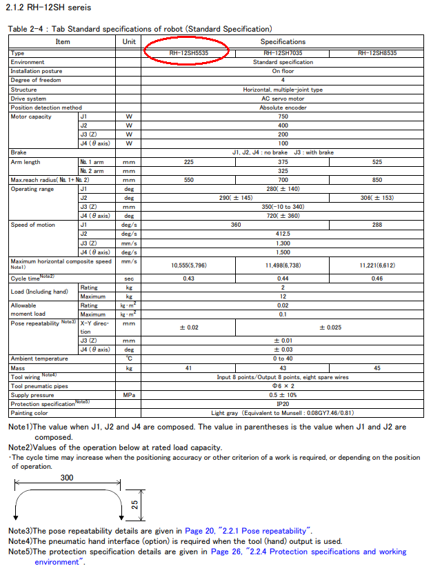

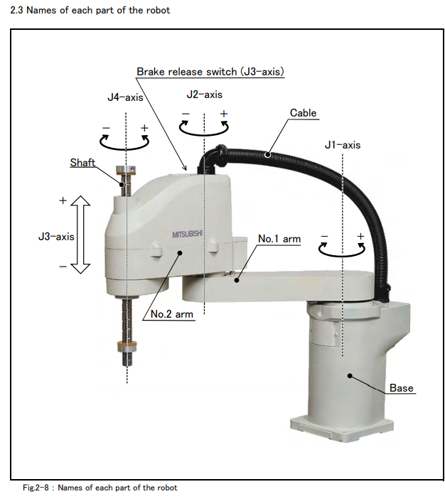

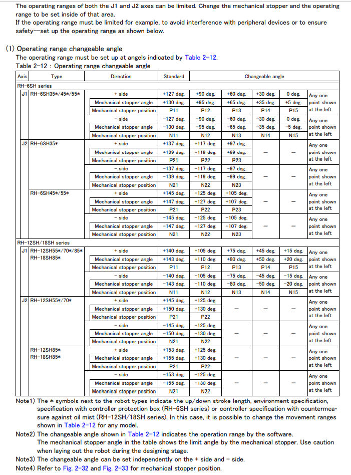

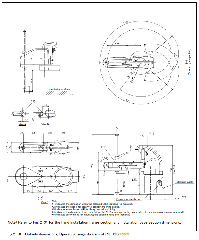

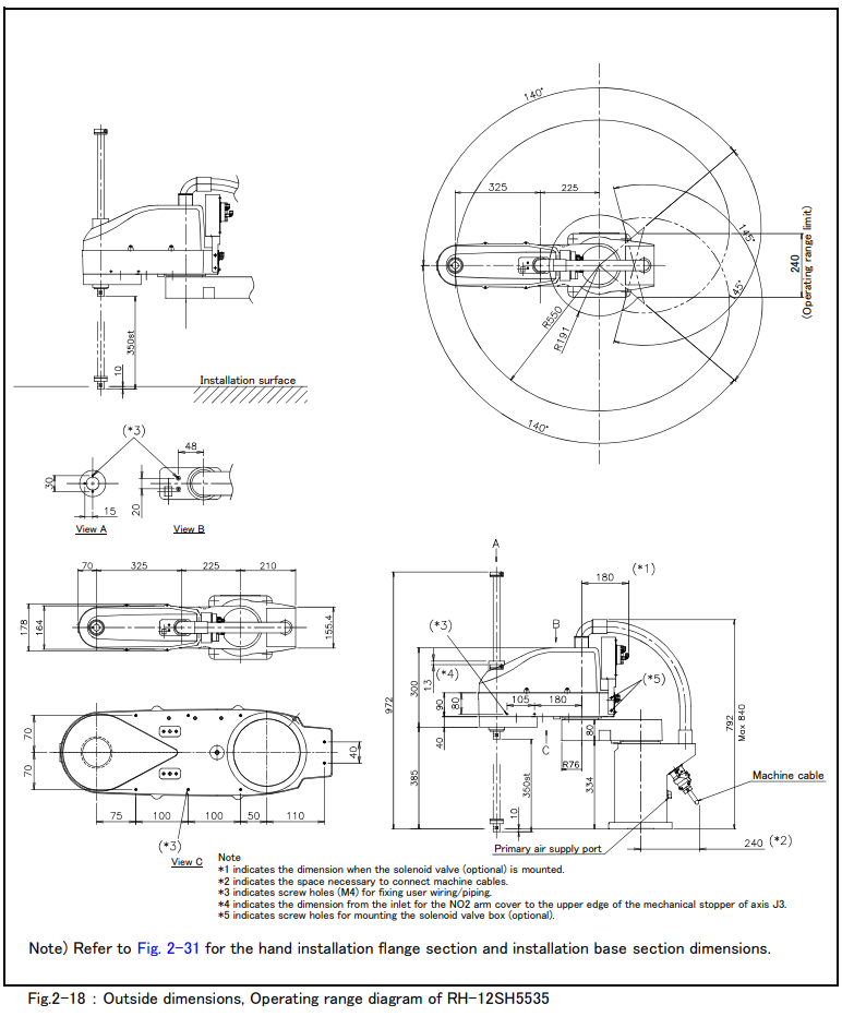

Hi Albert,
I called Mitsubishi and asked for this model type. I'm waiting for a recall of the technical support. In the meanwhile I copy the technical data from the operating manual. I attach the screenshots. The complete manual you'll find here. Operating manual RH-xxSH-series
Thomas
