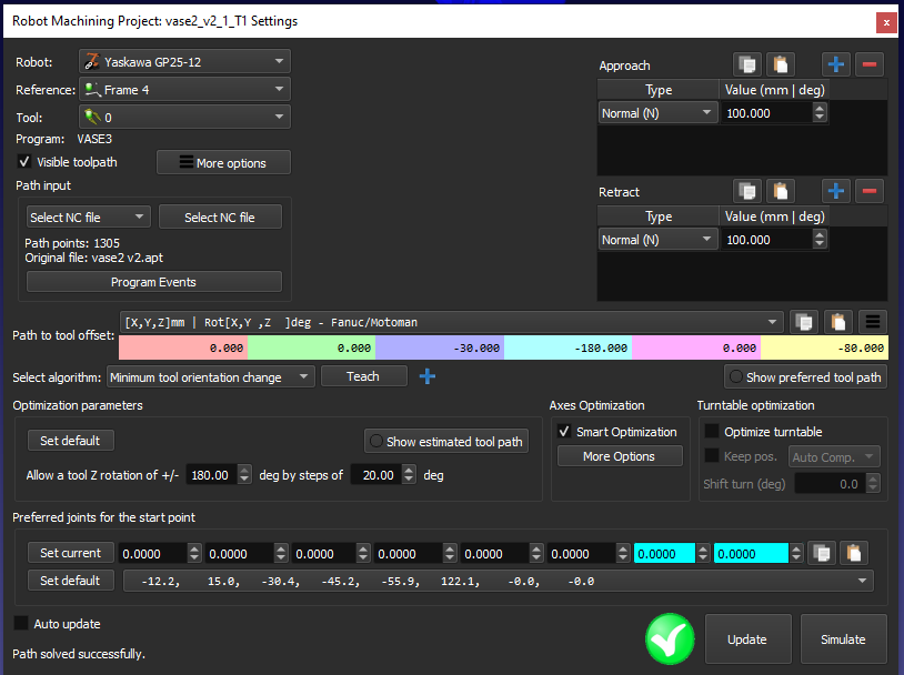

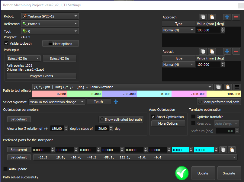

If you add a toolpath and set tool offset for the 2nd rotation to -180 as shown in capture1.
Close the option window and reopen. The 1st rotation will be -180 and 2nd rotation is 0. You have to redo this every time you close and reopen the option window

This behavior is normal because Euler angles have multiple ways to represent the same rotation. For example, a rotation of -180 deg around the Z axis is the same as a rotation of +180 deg around the Z axis.
