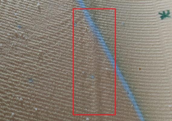

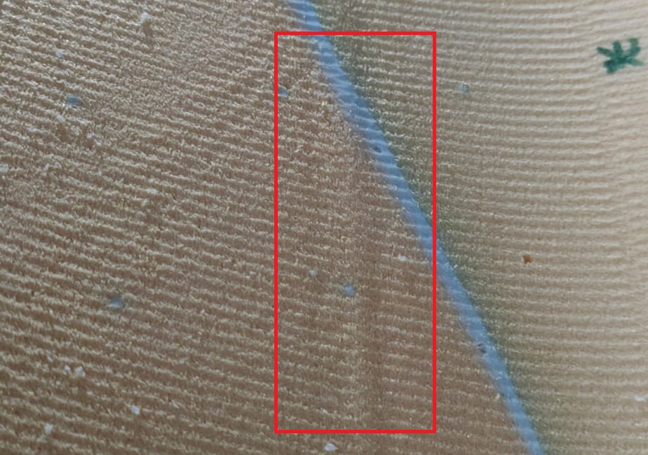

We are currently testing the capabilities of RoboDK for mold manufacturing and have encounter some limitations that produce uneven surfaces.
As seen in the picture, the surface has the normal scallops from the ball-end milling and two other grooves that we suspect are coming a sudden change in wrist configuration.
Screen Recording 2025-11-13 083516.mp4 (Size: 3.58 MB / Downloads: 310)
Is there a way to automate the tool rotation along the path to avoid any sudden configuration changes? Or a way to set it manualy like the robot axes map from other softwares?

I have also attached the .rdk station for you to see our machining settings
