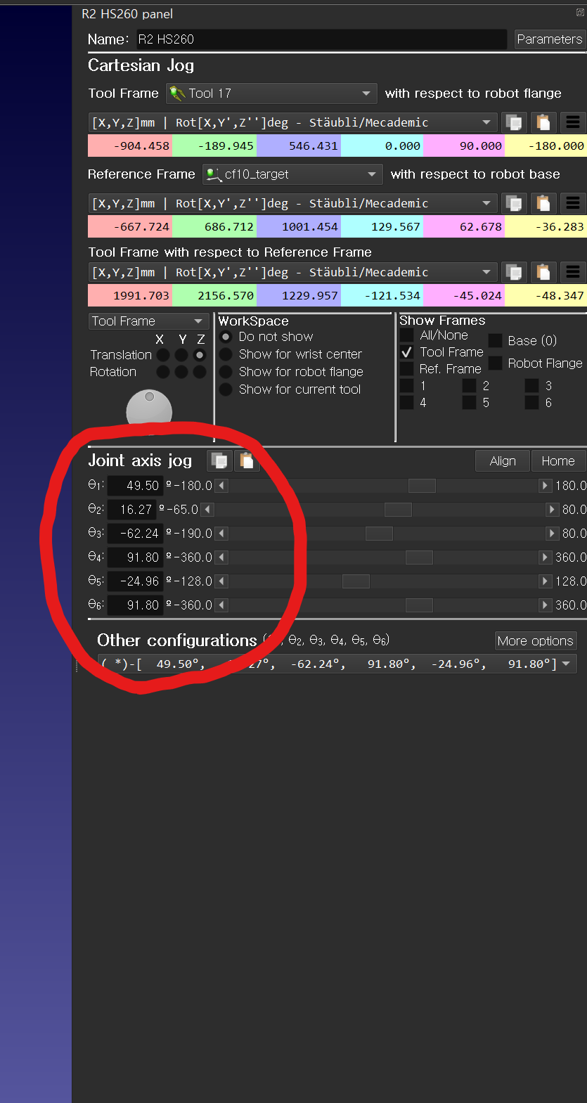

I am tring to extract each Joint's angle of 6 axes industrial robot to Python code.
Is there any way to extract it???

I am also looking for other postures of the robot.("Other configurations" in the picture)
Do you know to extract these postures??
I think you can use SolveIK_All() for that:
https://robodk.com/doc/en/PythonAPI/robo...olveIK_All
robot = RDK.Item('YourRobot',ITEM_TYPE_ROBOT)
all_solutions = robot.SolveIK_All(robot.Pose(),robot.PoseTool(),robot.PoseFrame())
print(repr(all_solutions))
