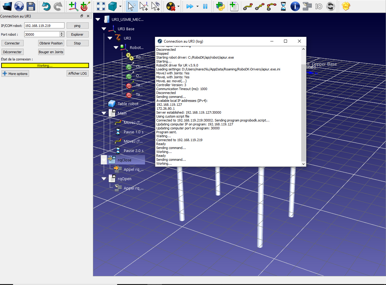

I have a UR3 arm with a CB3 series controller and a RobotiQ Hand-E Gripper that I'd like to operate from the UR controller.
URcaps : Robotiq_Gripper ver 1.8.11.21258
URSoftware : 3.15.8.106339
My Windows Firewall is disabled
I am trying to operate the RobotiQ gripper directly from RoboDK using the driver.
I found and installed your driver : progrobodk.script
and followed the steps as per required :
2. Unzip the progrobodk.script file in C:/RoboDK/bin/progrobodk.script
3. Make sure to restart the driver if it was running (double click Disconnect, then, Connect).
4. Select Tools-Options-Drivers
5. Uncheck the option: Manage program calls with RoboDK when connected to a robot
However, when I try to connect to the UR3 robot I keep having the same error :  'set_tool_communication' is not supported by this robot !
Could you please help me on that?
Luc

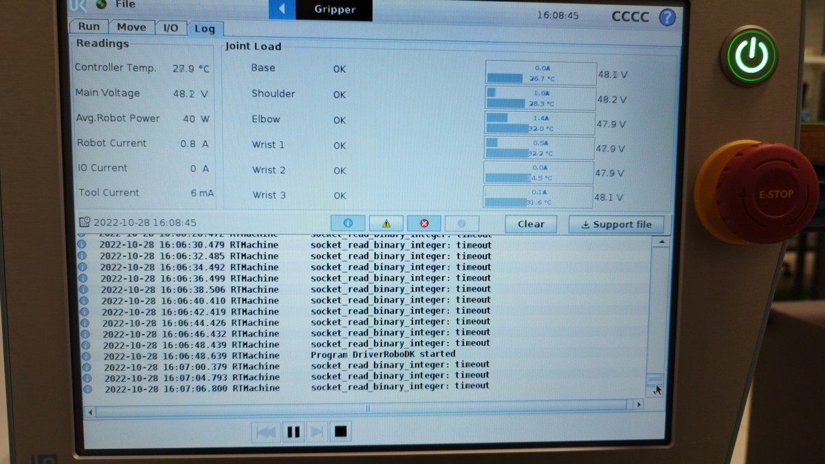

Hello again,
I used this tutorial:
https://robodk.com/forum/attachment.php?aid=2663
but get this message on my polyscope:
Set-tool_communication is not supported by this robot.
Is there a solution? I have a CB series.
Regards,
Samira

Hi Samira,
Like me, you may have an older versions that don't have the tool communication you should use this attached file version of the progrobodk.script
.zip   progrobodk-rq-no-tool-com_2022.zip (Size: 5.31 KB / Downloads: 647)
