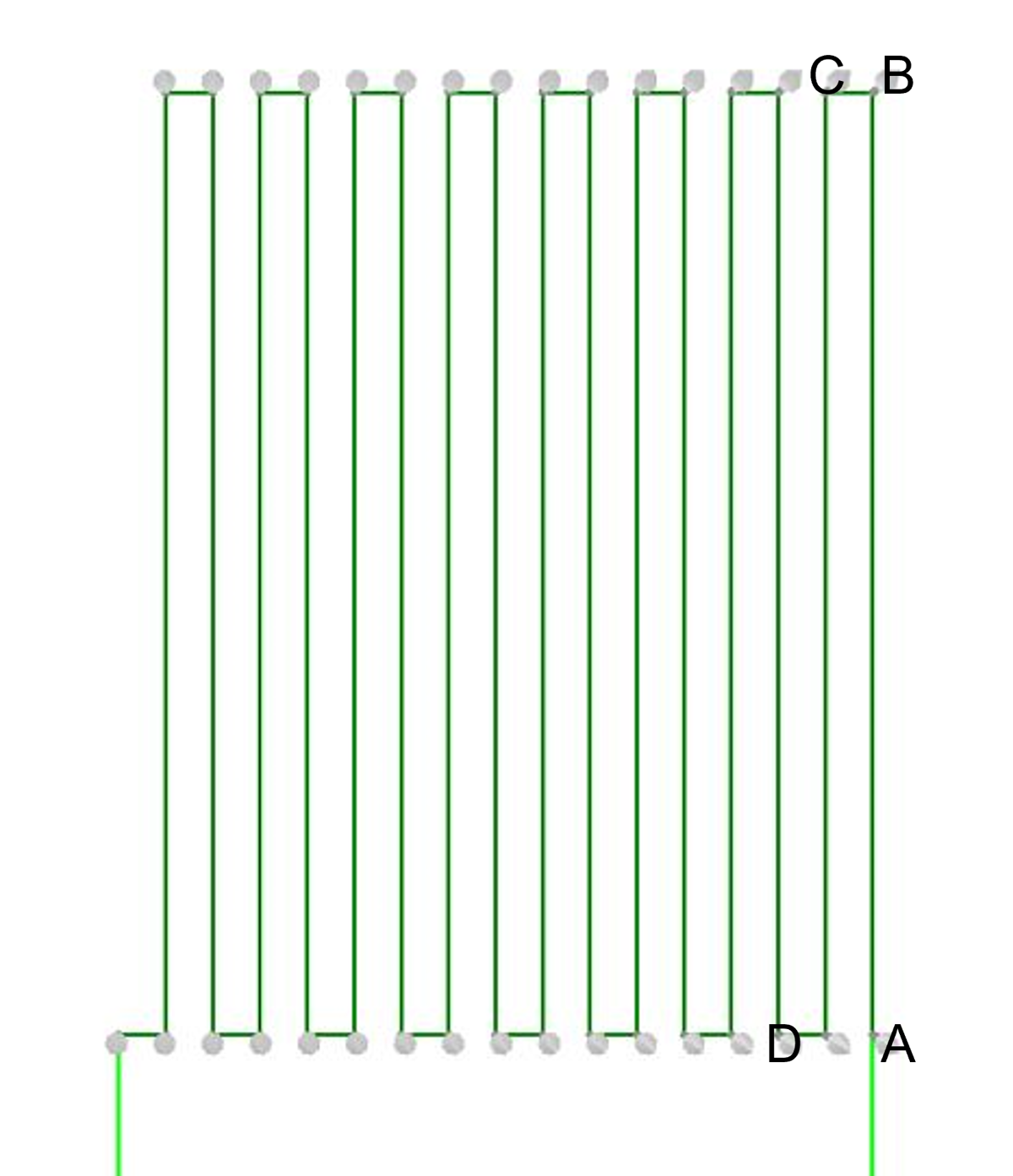

I tried two methods to run an identical program "Substrat1". When I use "Run on robot" then run manually RobodkSync35.src, the robot starts at point A, goes to point B, stops and starts again to go to point C. But When I generate robot program "Substrat1.src" , copy this file on SmartPad and run it, the robot doesn't stop at every point and that's what I want.

I added the src file "Substrat1" and a picture of the pattern.

To create that path it's very likely you use the Curve Follow Project feature.
If you select "Program events", you will see a "Set rounding" option. This option, if activated, will blend the motions together so the robot keeps as much of its velocity as possible.
If you want to robot to stop at each point, you can simply uncheck it.
This feature only applies to "Generated" .src file.
For the "Run on robot" feature, a handshake must take place in between each move (for safety reasons) forcing a short stop at each point and preventing any blending.
