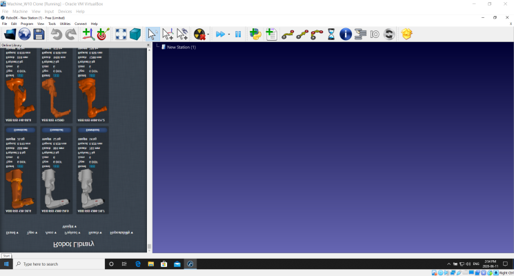

Hi Albert, Thank you so much for your help. I solved the problem by enabling the 3D acceleration property from my vBoxSVGA graphic controller. Now, the problem is that the library is shown upside down and it's really hard to choose any element from there because of this reason. I attach a screenshot of this event.
This is very strange... it is the first time I see this. This issue is probably related to the setup of your VM.
I recommend you to use the online library through a browser and load the robots manually.
