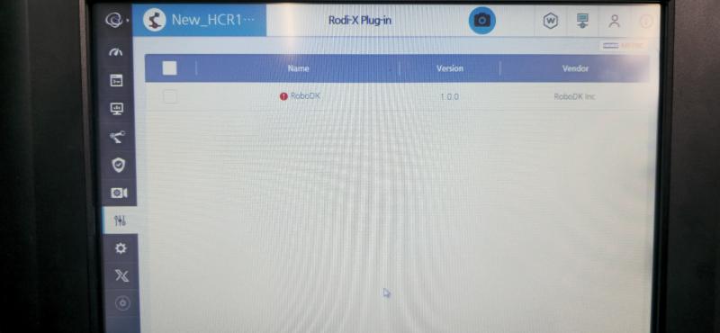

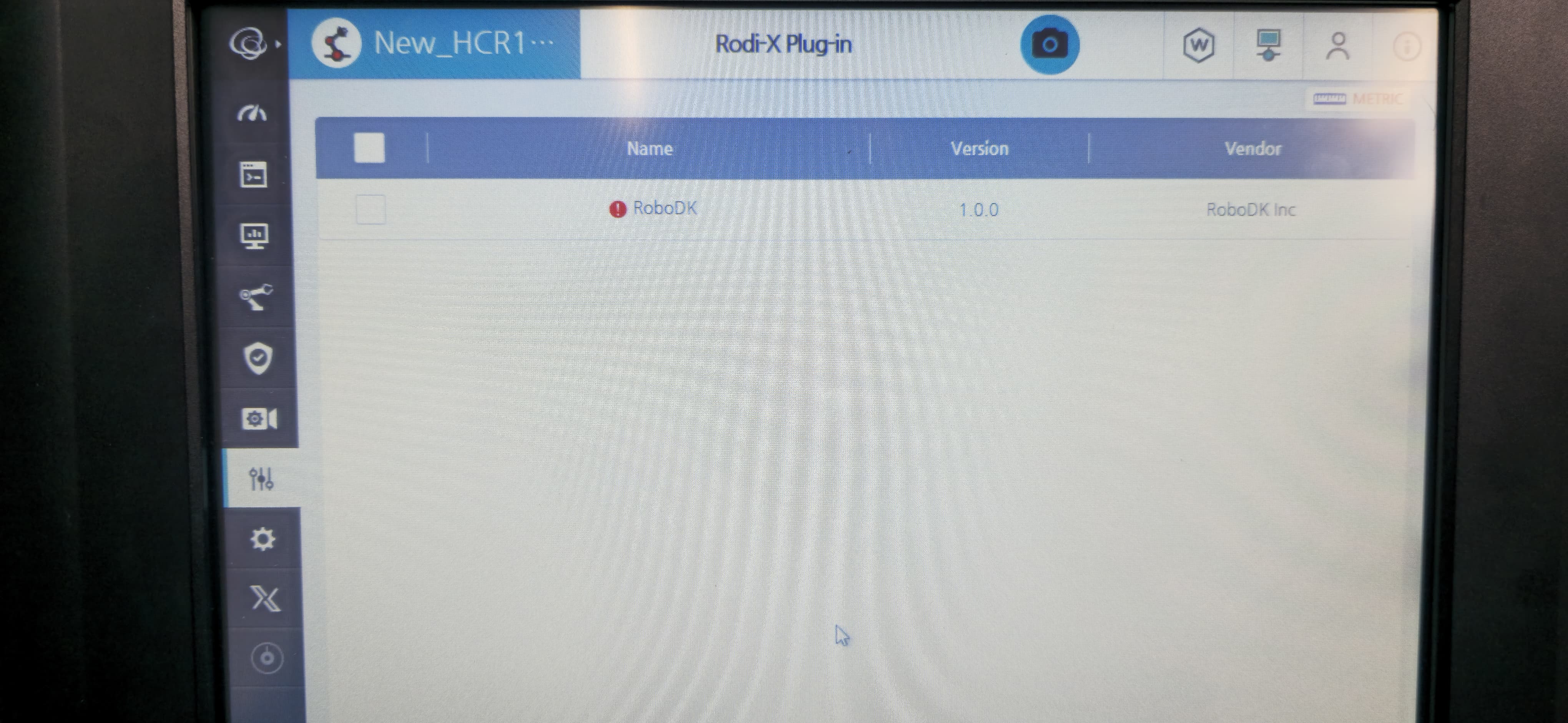

2. Added RoboDK.asar file to the HCR-12 from USB Drive (Rodi>>Management>>Rodi-X Plug-in>>Add) and restarted the HCR-12

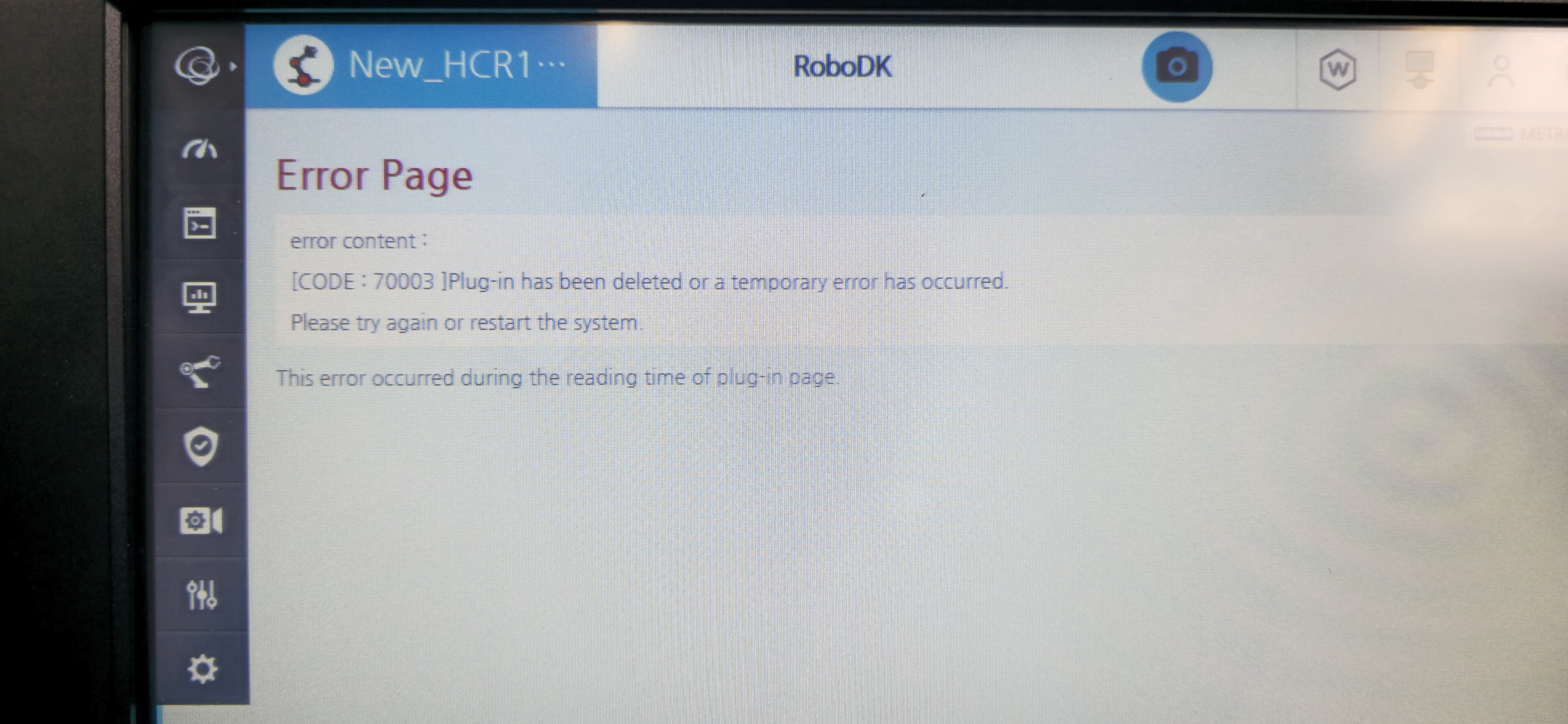

(Now its showing a red exclamatory mark infront of RoboDK (under Name field) and When I tried to choose plugin from Rodi>>Rodi X>>RoboDK its showing an error content: [CODE: 70003] Plug-in has been deleted or a temporary error has occured. Please try again or restart the system. This error occured during the reading time of plug-in page.

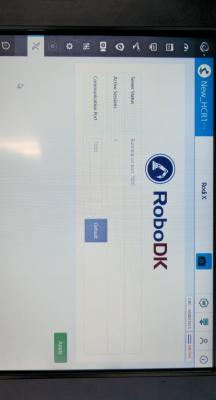

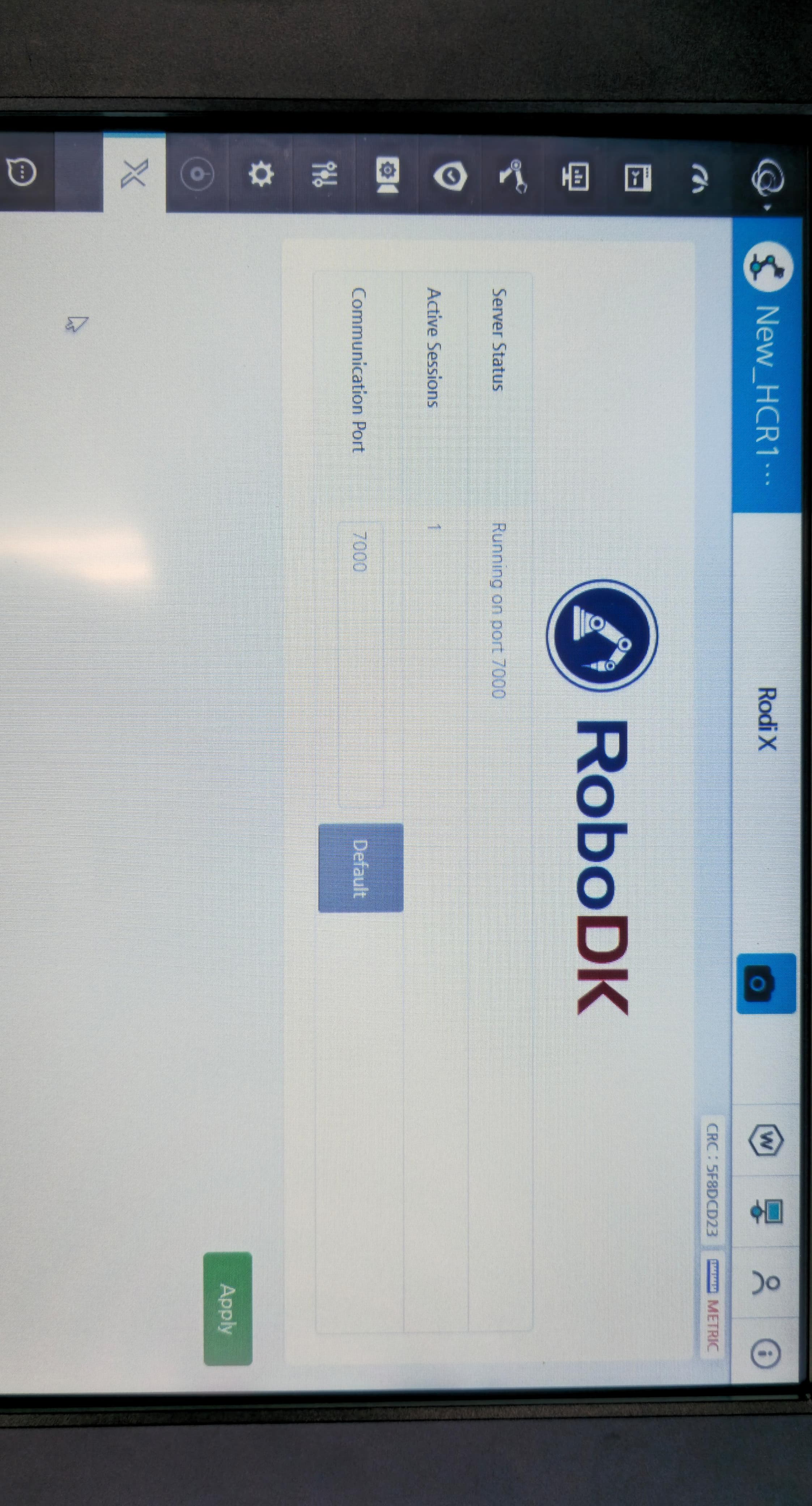

Thanks for your support. Meanwhile I contacted Hanwha Support and they have provided a new software update. After installing this update , RoboDK plug-in is working now. But I have to do some test programs to see its working well or not.
Software Version:
Rodi S/W: 2.009.000
Controller S/W: CLINK.v2.009.000.008
Build No: 008_G1
Regards,
Rahul Antony
