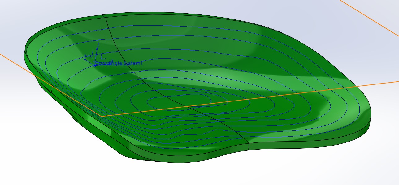

Initial trial we're trying to do is via Solidworks, which is our in-house CAD package and one a few of our clients use. Whilst I've been able to manually create a path in Solidworks, albeit a messy one, I can export to RoboDK and position correctly for the part. But, its a manually drawn path so isn't consistent with overlapping and may produce uneven sanding.
I could do with a face path generator, that creates the path, with options of overlap/blending radius, etc.
