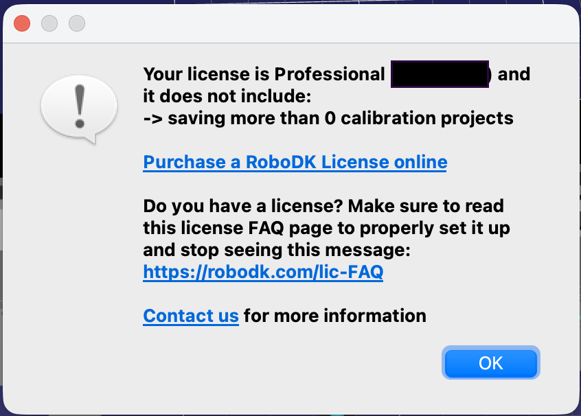

I am getting this message when I try to save the changes of my file, any idea why is that? Do I really upgrade my license to save "calibration projects"? This does not make sense to me
If you have a RoboDK professional license without the robot calibration option you should be able to save your project once you remove the robot calibration project that may be available on your station.
Do you have a robot calibration license?

Yeah, we have multiple licenses and realized that I was using the one without the calibration 😅 I was able to save it once I moved to the other license. Thanks for getting back to me.
