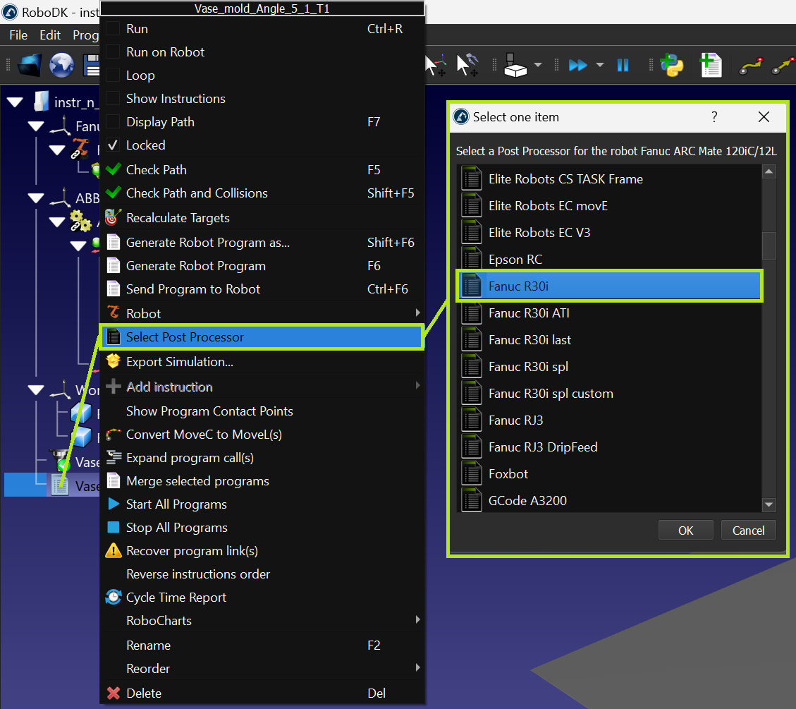

This is an outdated postprocessor.
Please scroll up this list and select one of the latest Fanuc postprocessors (e.g. R30i or RJ3 versions)

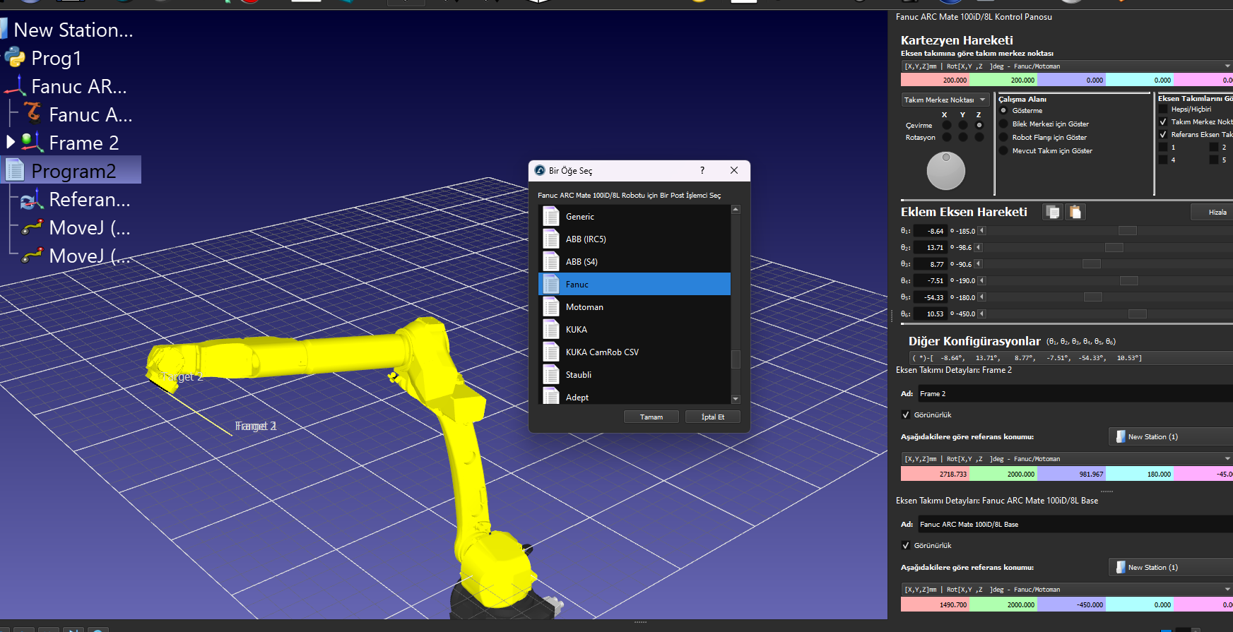

When I select Fanuc R30İ or Fanuc RJ3 in the Post Processor section, I receive the following error in the Create Robot Program section.
Attached Files Image(s)

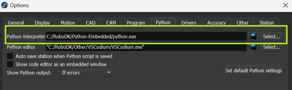

Could you please try the Python-Embedded that comes with the RoboDK?
Tools->Options->Python:
