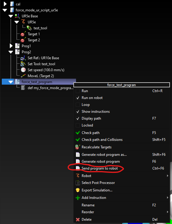

I am trying to use the force mode on the UR5e robot. I've put my URscript force mode code in a RoboDK program called "force_test_program" as shown in the image.
If I right click on "force_test_program"  and click "Send program to robot" the URscript code executes as expected. I'd like to be able to do the same via the python API. How can I "Send program to robot" from the python API?

Using the API you can send the program to the program to the robot by calling the MakeProgram function using the corresponding flags. Example:
program.MakeProgram("", RUNMODE_MAKE_ROBOTPROG_AND_UPLOAD)
https://robodk.com/doc/en/PythonAPI/robo...akeProgram
