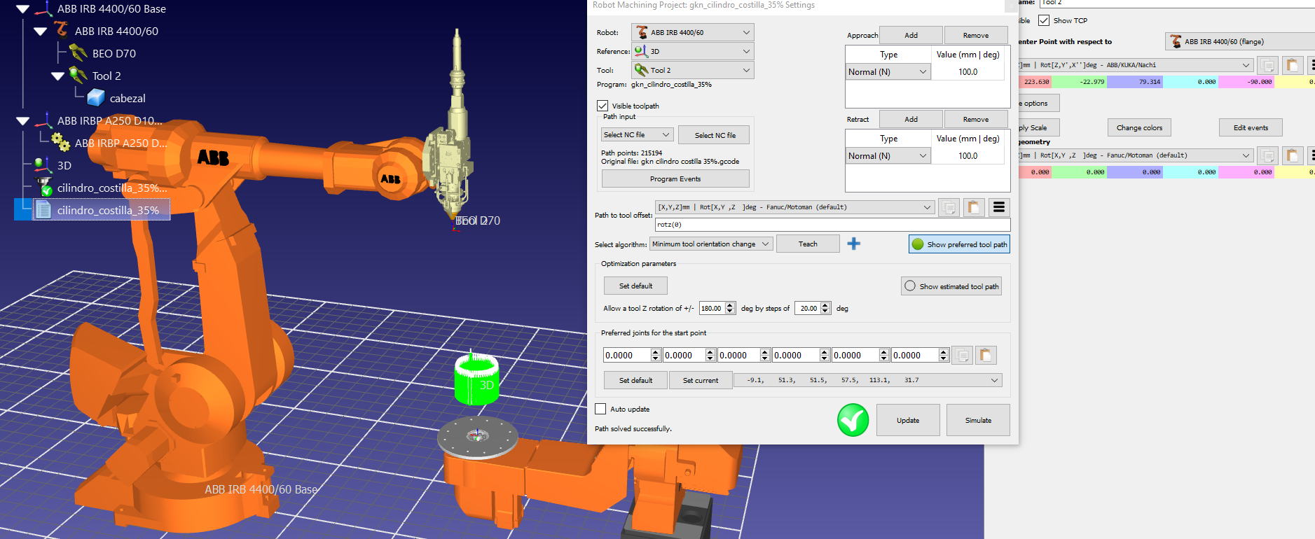

Hello everybody,
I would like to know if  it is a problem or if I am doing something wrong. I want to show preferred tool path but i am not able to do, sometimes works and sometimes not. The tool is activated as you can see...
Any idea?
thank you in advance!
Hi there,
I believe that the problem comes from the fact that you use "Tool 2" and "Tool 2" seems to just be a TCP.
If the selected tool does not have a 3D model, the "Show preferred tool path" can't show anything.
Have a great day.
