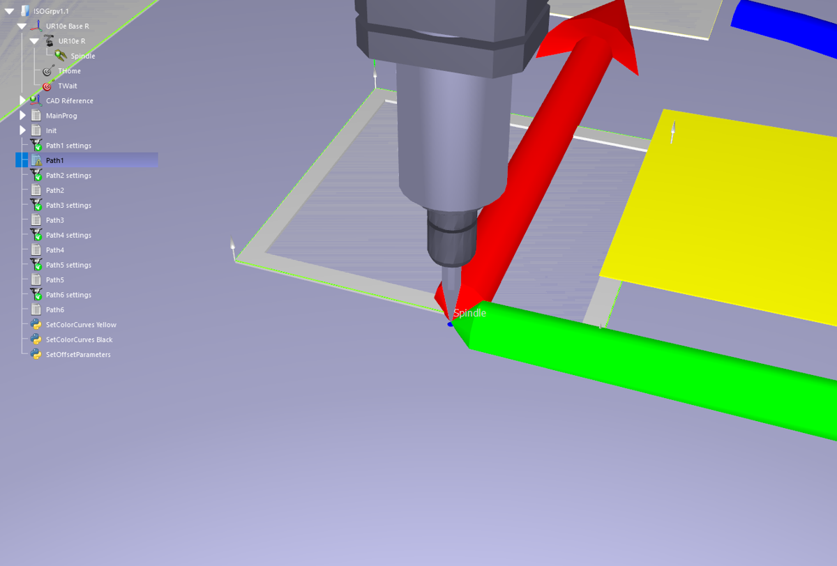

Hi Ned,
Yes, you can activate the simulation of the trace following these steps:
  1. Load the 2 scripts called SpingleOn and SpindleOff available here:
  2. C:/RoboDK/Library/Macros
  3. Trigger the call to SpindleOn to start deposition
  4. Trigger the call to SpindleOff to stop it
This concept is implemented in the attached example.
.rdk   KUKA-Turntable-Spindle-Trace.rdk (Size: 1.44 MB / Downloads: 1,173)
Thanks it work Thanks Ned
