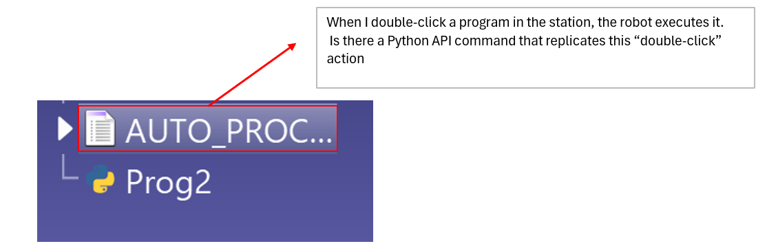

  1. When I double-click a program in the station, the robot executes it. Is there a Python API command that replicates this “double-click” action  (i.e., execute on the robot)? My goal is to automate the entire process from program creation to execution on the actual robot.

Also you should be able to provoke the same double click event on any item by triggering the parameter "Action" with value "DoubleClick". Example:
program = RDK.Item("AUTO_PROC")
program.setParam("Action", "DoubleClick")
