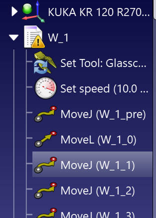

I have a question regarding running program of RoboDK smoothly. What I am doing currently is, I have an external Python script (not in RoboDK), I use it to generate a series of path points (let's say I get 100 path points). I save the path points as targets in one RoboDK program (W_1 in the picture attached) and connect RoboDK to the real robot. When I execute the program W_1, the robot starts to move to the targets one by one, instead of running them all.
