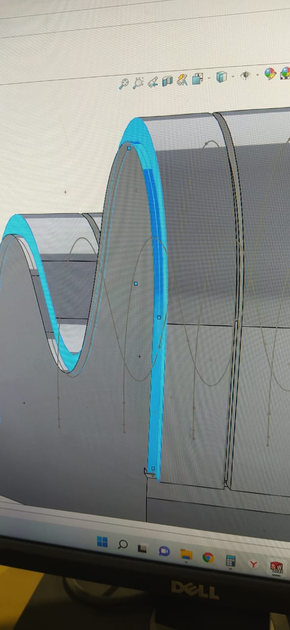

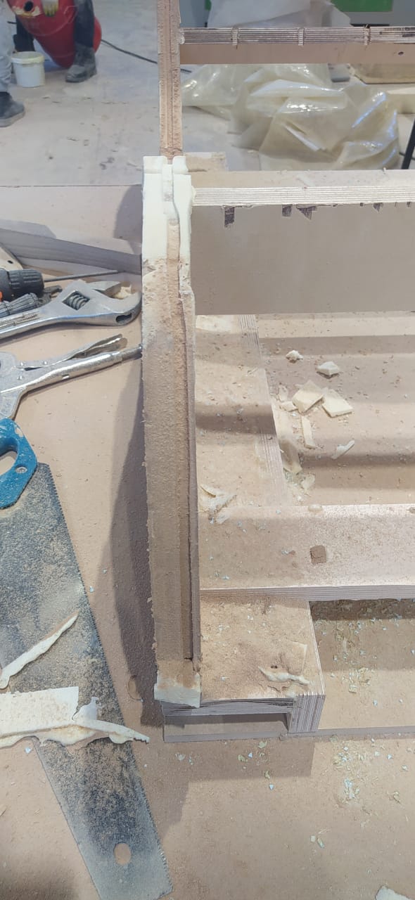

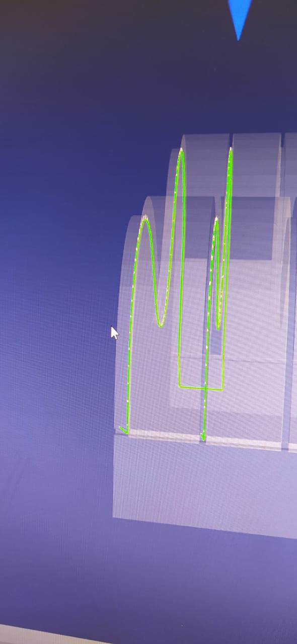

Привет. программирование робота в роботке. Я создаю траекторию с помощью SolidWorks. Линии все прямые, а по факту получается со смещением. подскажите, что можно, или скачать другую программу на место солидворкс и там попробовать?

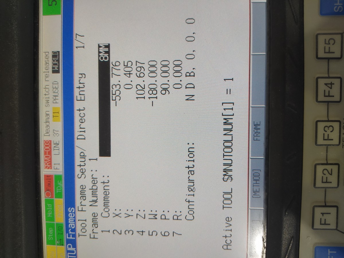

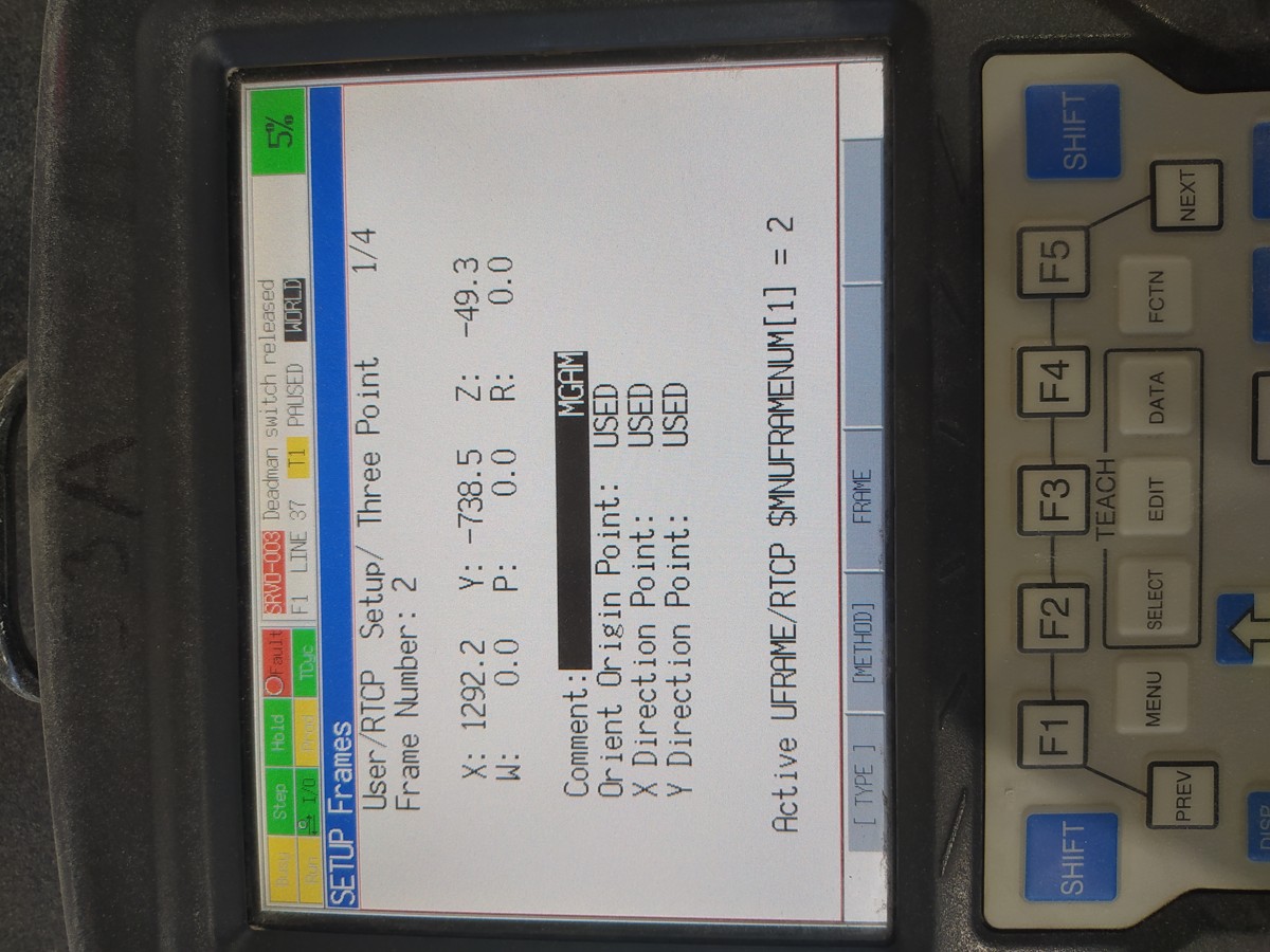

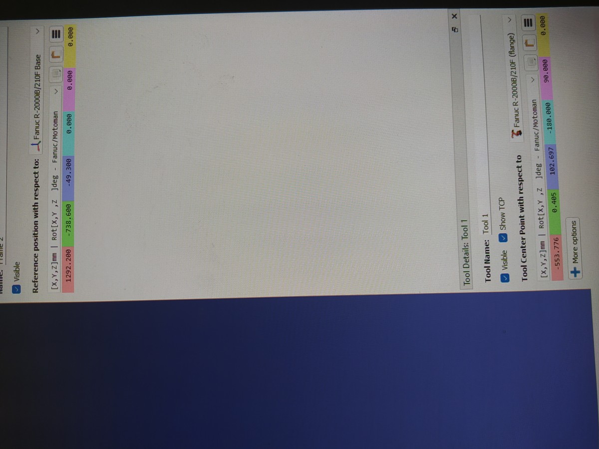

This looks more like a robot setup problem than a software problem.
How did you set up your tool and how did you set up your frame?
[quote= 16482109508227925139722417801809.jpg    16482108640727072277019579476893.jpg    16482107888334809887553102009061.jpg
I'm sure they are the same in RDK and in the controller but are they right?
What I mean by that is, does your in the virtual environment matches with your part in the real environment.

did everything as in the video. in 2d processing is good, in 3d there are displacements.

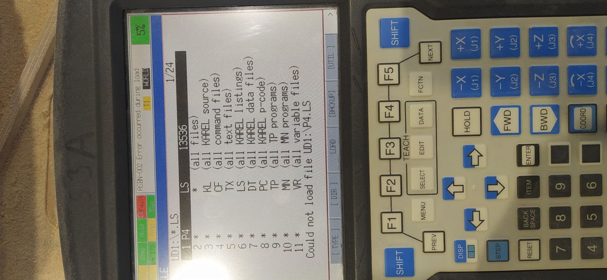

I have an r 30ia controller. fanuc rj3 postprocessor works and r30ia postprocessor doesn't load into controller ?
What error message do you see when you load the file?
Can you share the complete error log? We are unable to help you troubleshoot without more information.
