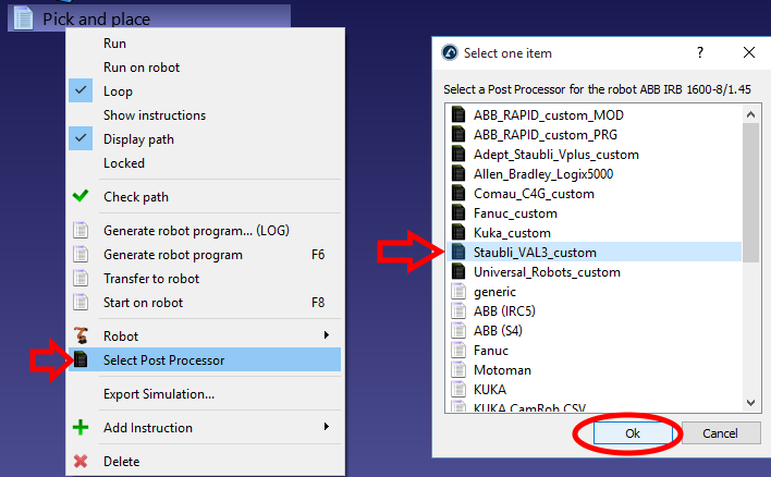

We have a some post processors that support Staubli's VAL3 controllers (see the sample post processor attached).
To try it, you must place this file in the folder "C:\RoboDK\Posts\", then, right click your program, then "Select Post Processor" and select VAL3's post. You can modify it manually or by selecting "Program->Add/Edit Post Processor"). This post is not provided with the default install as we have never tested it and probably needs some retouching. If you have a chance to try it and provide feedback we can improve VAL3's post.
