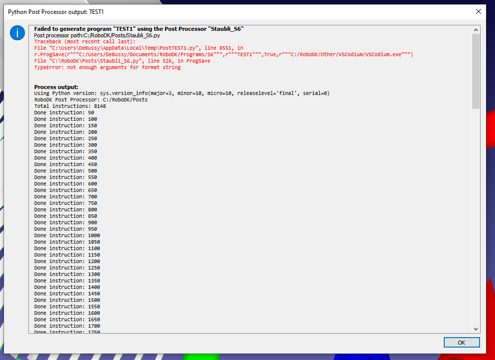

Working with Staubli TX90L and CS8C Controller. when I try to generate program what is 2 axis (movements only X and Y) the program generates with no problems and controller is able to run as well (Thanks to Albert's help)
attached station includes 5 axis toolpath I am trying to generate but it gives me the error shown on the attached picture. Do you guys have any idea what the issue could be?
Thank you in advance!
.rdk   TX90L CS8C STATION.rdk (Size: 2.73 MB / Downloads: 502)
We were able to reproduce this issue. We'll be fixing this with the next release in less than a week.

This issue should have been fixed already with the latest version of RoboDK. At least with the latest Windows version.
