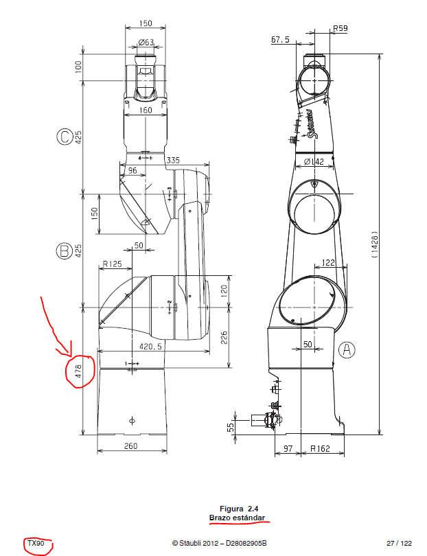

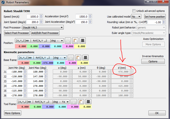

There is a mistake with the Kinematics of the Stäubli TX90 robot in the robot library. Please update the robot file.
Thank you!
Thank you for your feedback. I attached the Stäubli TX90 robot series with the correction you mentioned. We updated the robot in the library as well.
