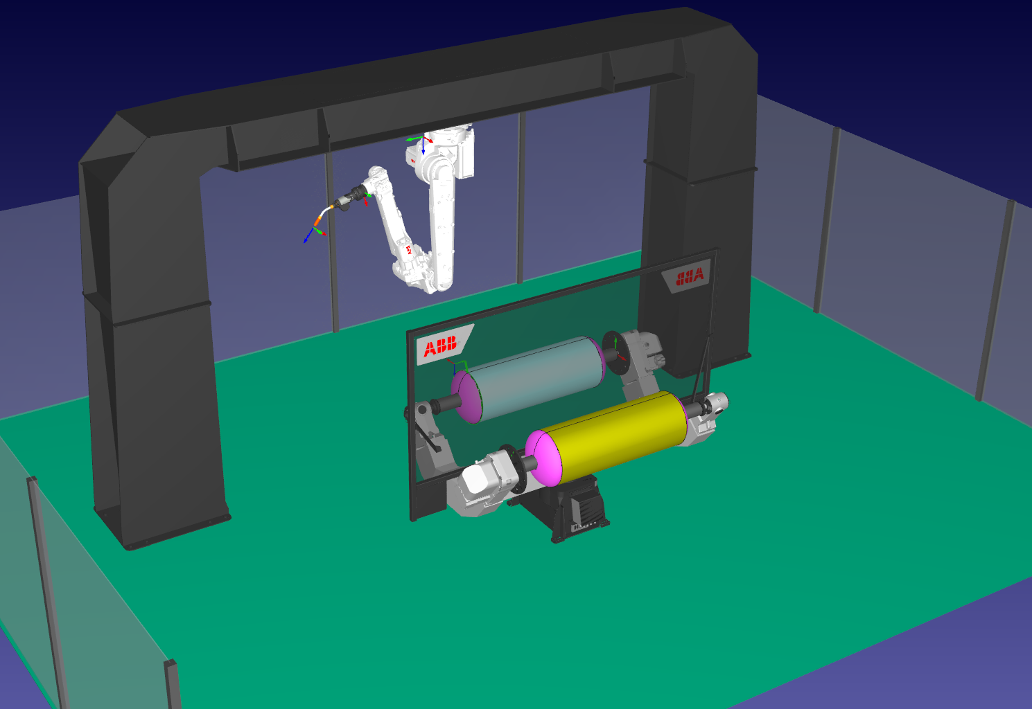

Hey, how can I synchronize external axises through the API and switch between different external axes in a curve follow projects settings?
For example, in the image attached, there are two single-axis positioners. If I create a curve follow project on one of the positioner and decide to move it to the other positioner. Can I change which positioner should be rotating within the project settings?

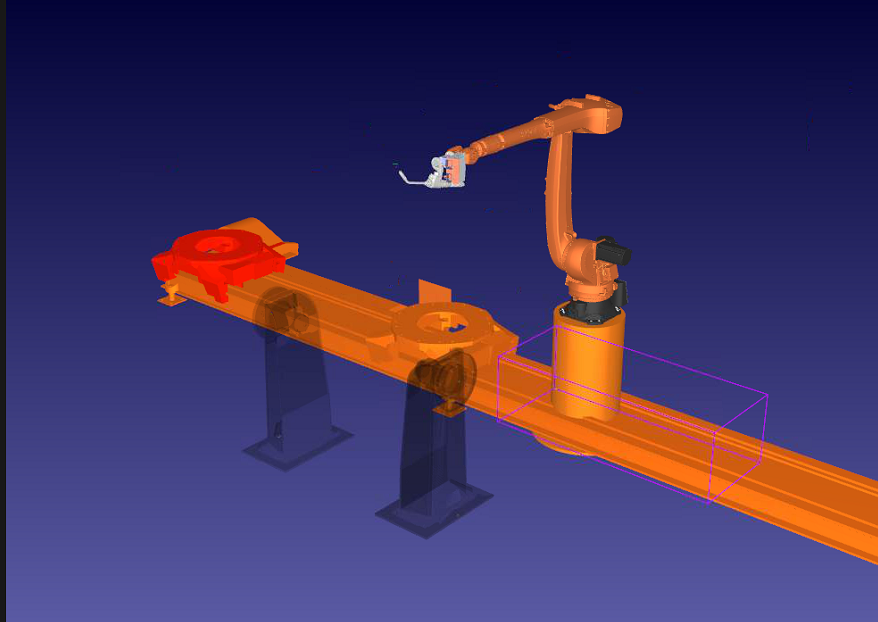

Hey Sergei, thank you for the help.
How can I sync both the rail and positioner to the Robot like the screenshot I attached?

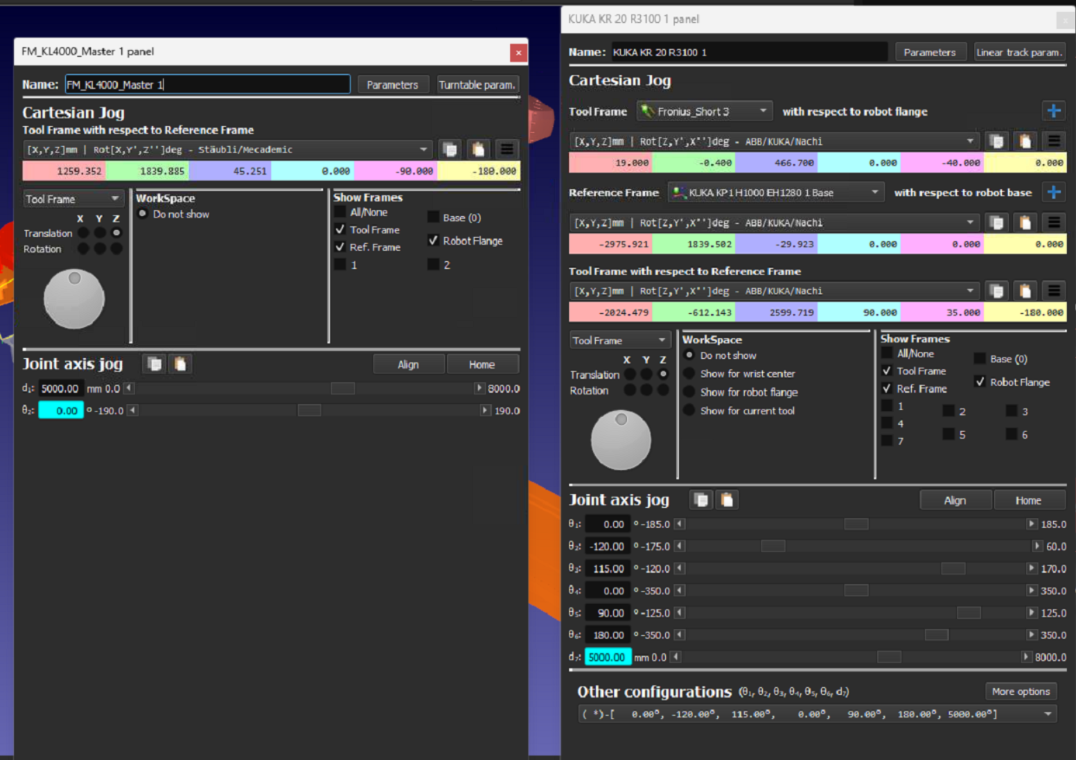

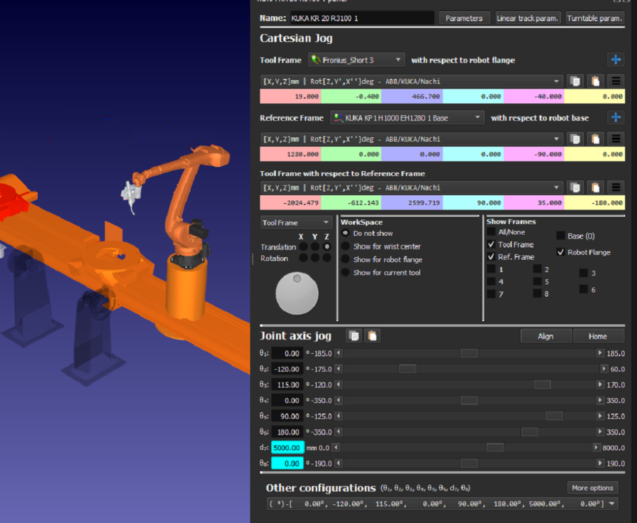

Hey Albert,
I've already tried this but it just creates a single link to the robot and rail, and the rail to the positioner. When I open the robot's options it only has the joint axis for the rail. On the rail's options it has the turntable's joint axis.
I believe when we sync all the robots together and open their options. The robot's options is meant to open is that correct?
I'm using RoboDK 5.6
