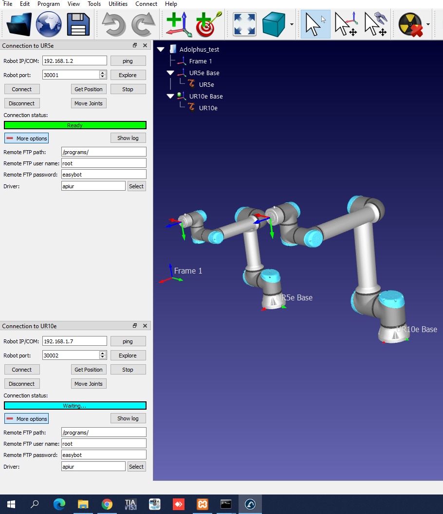

Would you please give us more info on the Connect-Connect topic? I am trying to go online with a UR5 and a UR10 at the same time. Connecting one of them works OK but connecting both at the same time fails. Any suggestions?
* I am using ethernet cables both robots are connected to my router.

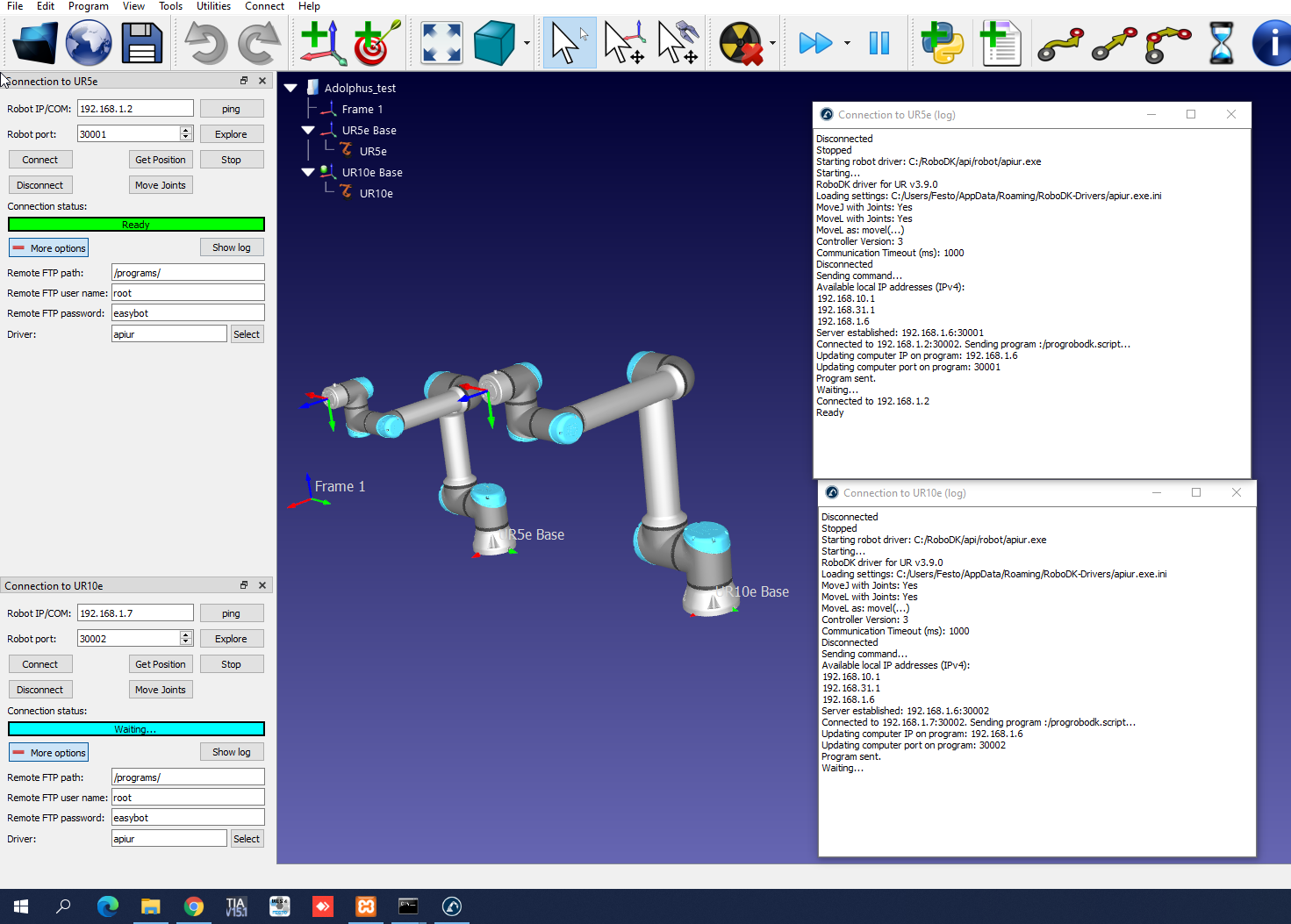

Please see the screenshot attachment for details.
Are you able to connect individually to each robot?
(08-12-2021, 10:24 AM)Jeremy Wrote: Are you able to connect individually to each robot?
Yes, I can connect individually to each robot. Please see the new screenshot. I used port 30001 for the ur5 and port 30002 for the ur10 but it keeps waiting. Thanks for the super fast response, greatly appreciated.
Hello Jeremy, I am adding a new screenshot with the connection logs if that helps.

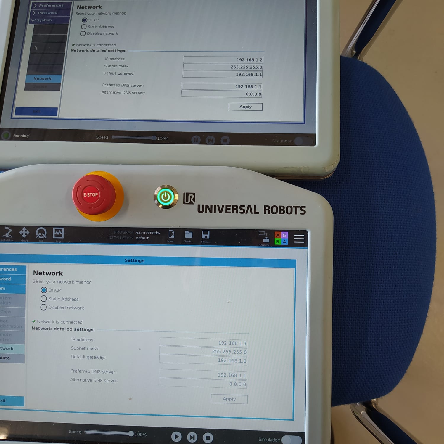

Polyscopes Image
