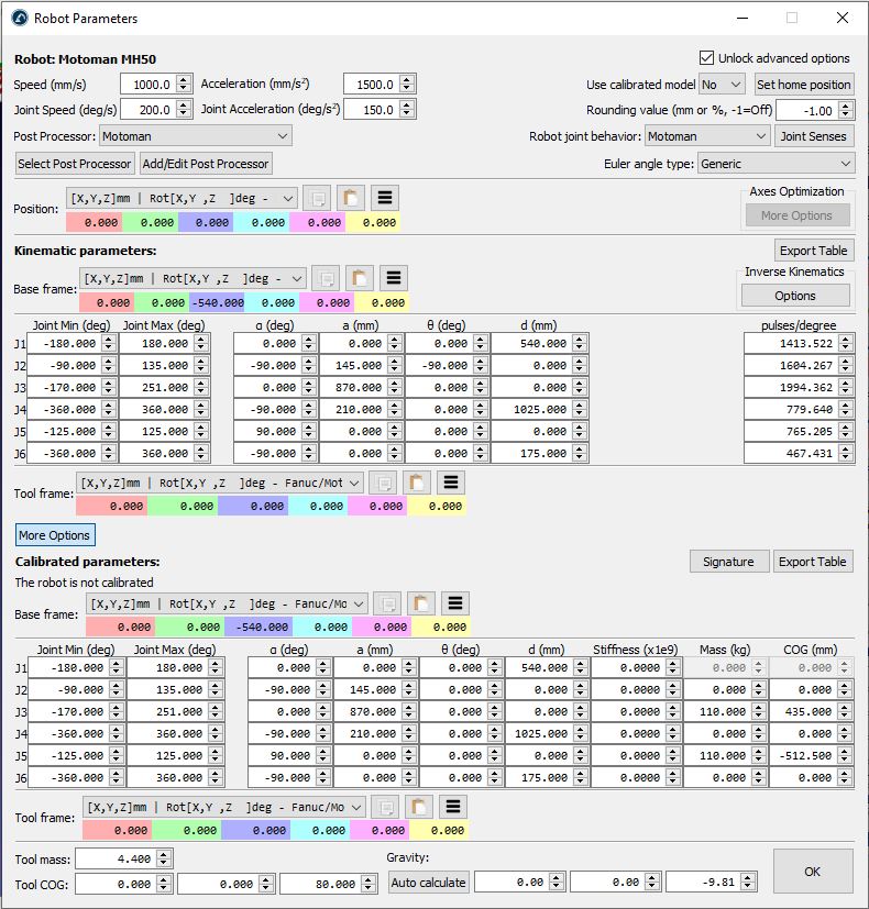

I am having an issue with the value of a target joint angle changing from the virtual to the physical robot. I am using the Motoman Post Processor, MH-50. I have corrected the 'sense' of the axis to match the physical robot.

Attached are the robot parameters.

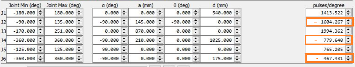

You can try to change the sign of the corresponding pulse/degree values:
This will invert the corresponding values of the resulting coordinates, which are output to the generated program as the number of pulses.
Thank you for the support. Changing the sign of the pulse counts resolved the issue. Thanks again.
