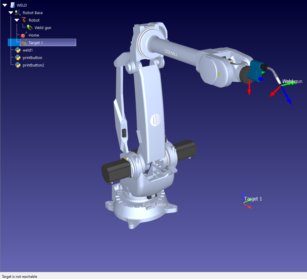

Target is not reachable
I want to take the inputs using root Tk() so I can make a target where the robot to move to do the necessary moves while it creates the target it show me that the target is not reachale which is not true because manually it can reach every point it needs to do all the work . This is the code for x,y,z inputs and this is the "error".

You are not specifying the orientation with the target you are creating.
You can try taking the orientation of your home target like this:
home = RDK.Item('Home')
target = RDK.AddTarget('Target1')
target_pose = home.Pose() # Create a copy of your home target
target_pose.setPos([x, y, z]) # Update the XYZ coordinates
target.setPose(target_pose) # Update the pose target
robot.MoveJ(target)
ok thanks it works perfectly fine
Great, thank you for your feedback.
