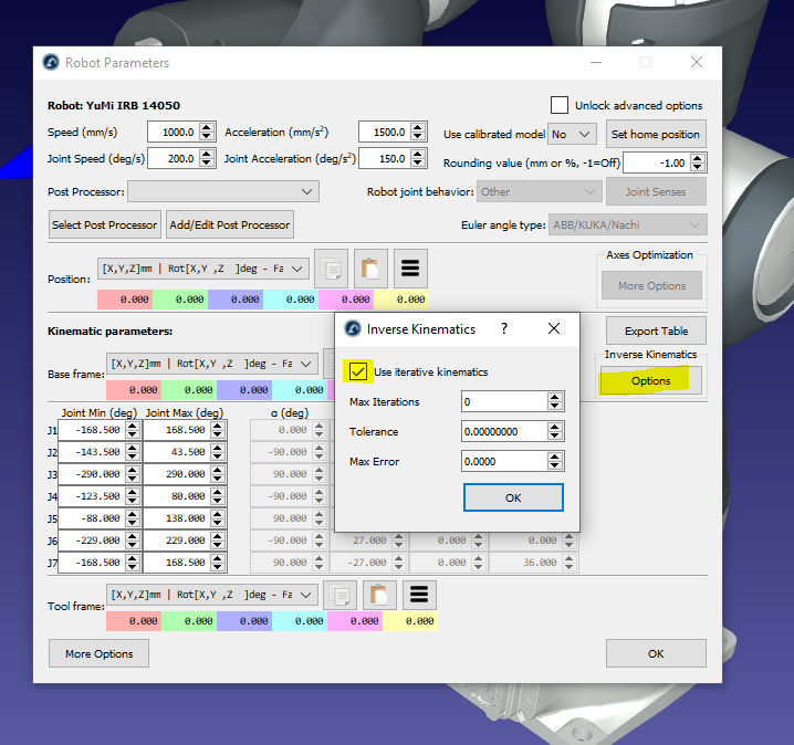

Thanks for writing in.
If you go to robot parameters and then to Inverse Kinematics options, selecting 'Use Iterative Kinematics' should fix this issue.
Find snapshot attached.
Hope this helps.
