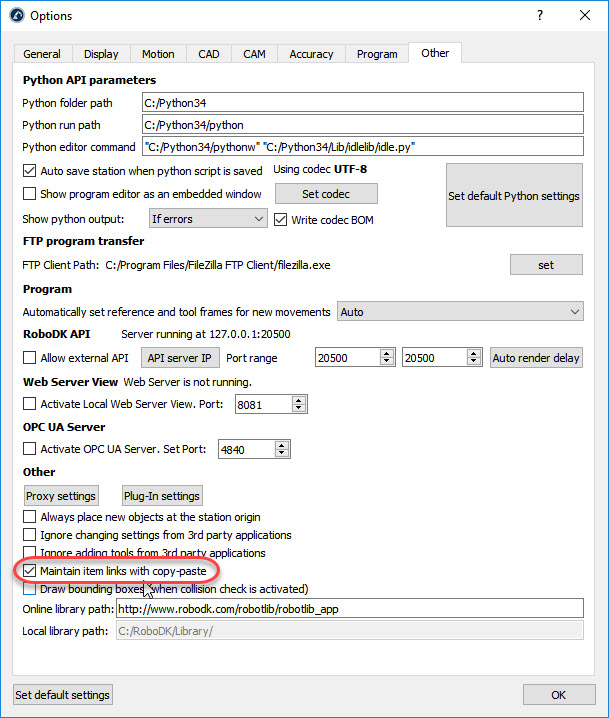

You can select this option:
Tools-Options-Other-Check: Maintain item links with copy-paste.
The latest version of RoboDK allows you to assign a robot to multiple targets and change target properties.

(12-03-2018, 09:02 PM)Albert Wrote: You can select this option:
This is not a bug so I'm moving this thread to the generic section.

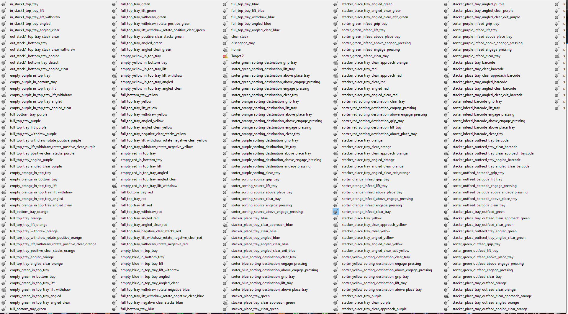

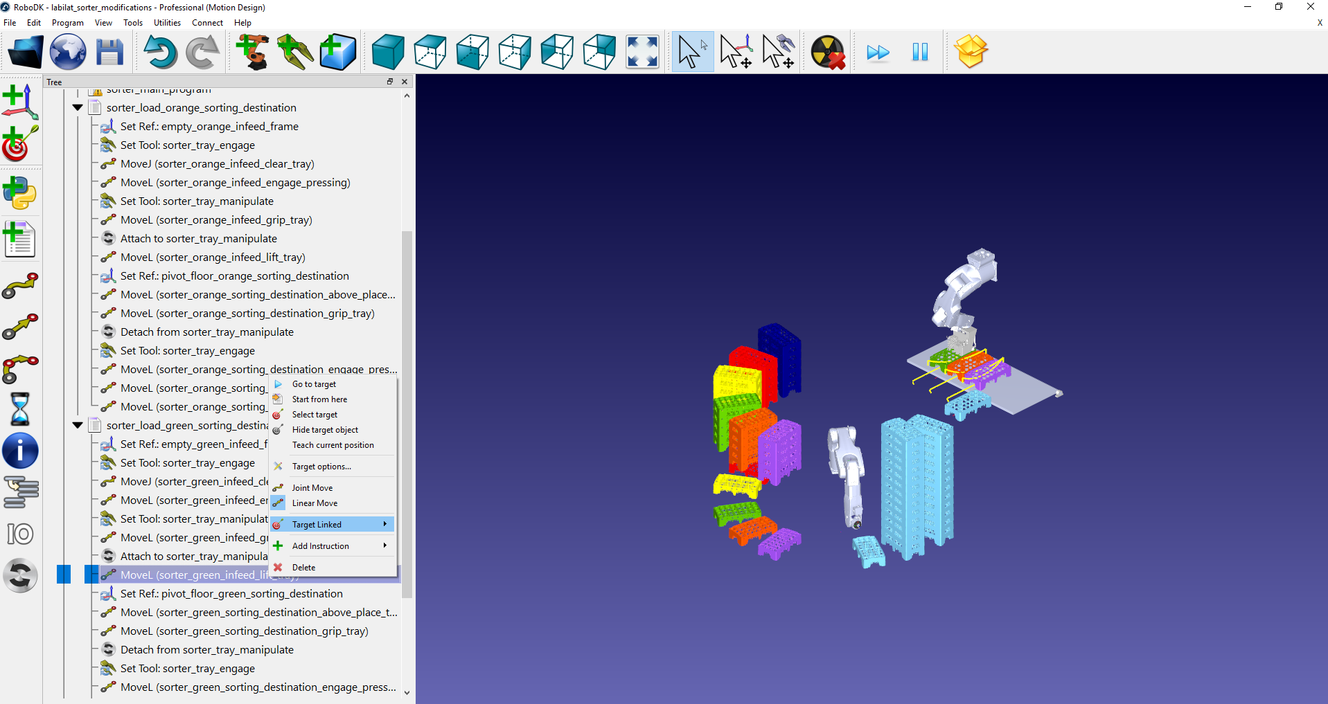

I'm working on a station that has many targets, I am duplicating a program sequence and then re-associating the copied moves Target Linked. Because I have so many targets (greater than one screens worth) it is impossible to select the targets I want from the Target Linked menu as it is off the screen and there is no scroll bar for this dialog.
Could this dialog menu be scrollable or filterable by name or could a python API function be added:
move=RDK.Item("Move")
new_target=RDK.Item("NewTarget")
move.TargetLinked(new_target)
See attached images for reference.

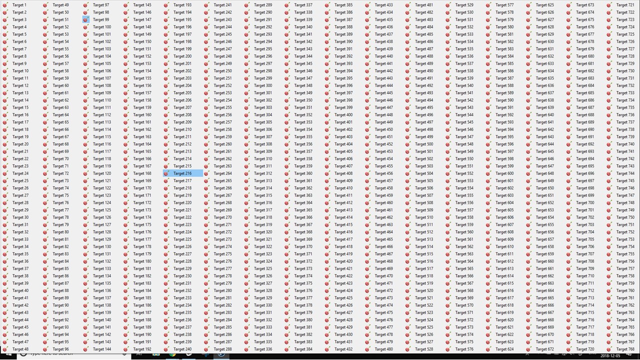

You bring up a good point here. I don't think we ever faced that problem. We will take a look at that.
In the meantime, you could try reducing the length of your variables' name.
For example, if you use the default name (Target #) you can select between 768 targets. (See image below.)

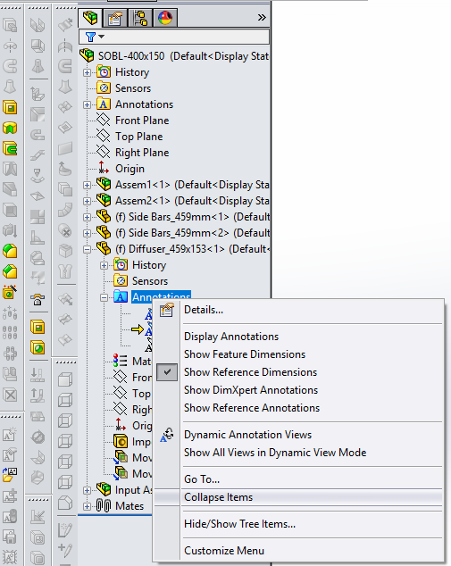

There is a usability improvement suggestion I have for working with larger projects with nested trees.
Solidworks has a option called Collapse Items which quickly collapses all nested tree items.
