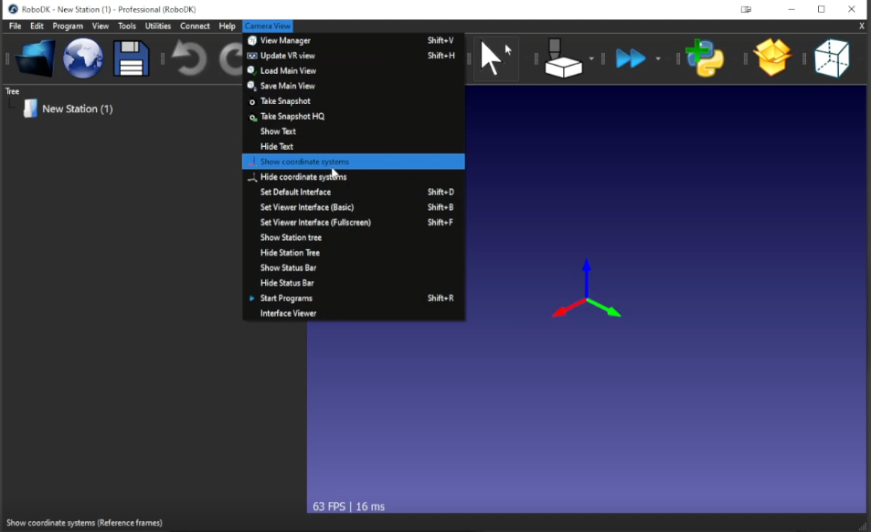

I have a problem displaying the targets and frames in RoboDK, as per the image attached below I already checked the visibility function for the target as well as the size from the Options tab. I tried different cells but nothing worked. This problem is for both targets and frames. Any help is appreciated.

Select "Camera Views" in the menu bar and then "Show coordinate systems".
Hi Olivier,
That worked, thank you so much.
