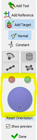

Hello,
When I use the function teach targen on surface I need to change the orientation. I would like to see and manipulate these values. Or is it only possible by rotating the blue, red and green knob?

Are you asking if it is possible to change the default orientation values used for the teach targets on surface?
If so, this is currently not possible. A workaround could be to change the orientation of your tool (TCP).

Hello Albert,
thanks for your reply. Yes I would like to change the orientation by typing in a value.

OK I understand better... Would it be OK if we added a right click option to enter the value?
We'll take your feedback into account for future updates.

That is a good idea and would help me alot to enter precision values.
