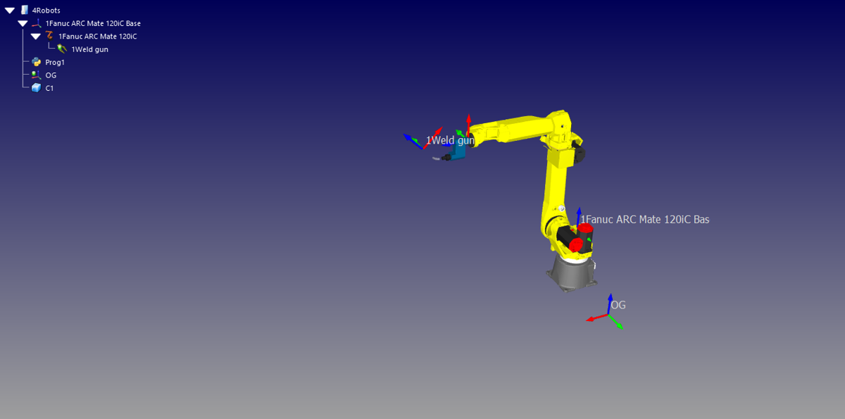

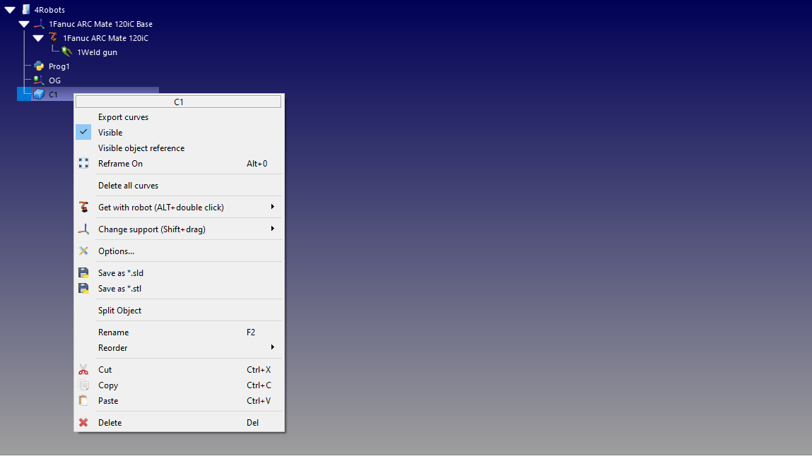

The curves that I import do not appear
I am trying to import curves as csv files and they are not visible in the interface. If I click "Reframe On" can´t see anything

Hi will27,
Check if you have "Display curve" option checked and "Don't display object smaller than" unchecked. You can find these options in Tools->Options->Display. Screen in attachment. I had the same issue and when I adjust these option like this then it was working.
Piotr
(09-08-2020, 12:44 PM)Piotr K Wrote: Hi will27,
Piotr
That was the problem. Thank you so much
