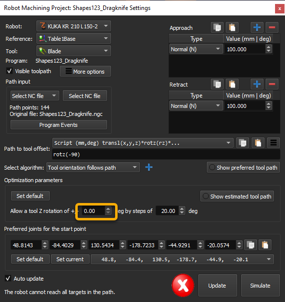

I have set up a station Kuka Robot as per attached.
There are 3 shapes to be cut with a circular saw tool, which means that we have selected "Tool Orientation follows path" as the default algorithm under Tools>Options>CAM.
We have created the following NGC files individually from DXF2Gcode and pasted it into the Robot Station.
1. Shape1Dragknife.NGC
2. Shape2Dragknife.NGC
3. Shape3Dragknife.NGC
During the simulation of each of the above-mentioned programs separately, the Blade tool orientation followed each path perfectly.
Then, to try and save time, we selected all 3 of the above shapes in DXF2Gcode and then exported it as one shape and named it "Shapes123_Dragknife" and then ran a simulation of this program. The Tool Orientation followed all the paths perfectly except for the 3rd shape where the TOOL ORIENTATION DOES NOT FOLLOW THE PATH for the last LINEAR MOVE of shape 3 where it starts with the correct directional orientation at the beginning of the last LINEAR MOVE but incorrectly changes the tool orientation further away from the Move direction as it moves further towards the end of the last LINEAR MOVE of shape 3. WHY DOES THIS HAPPEN?
