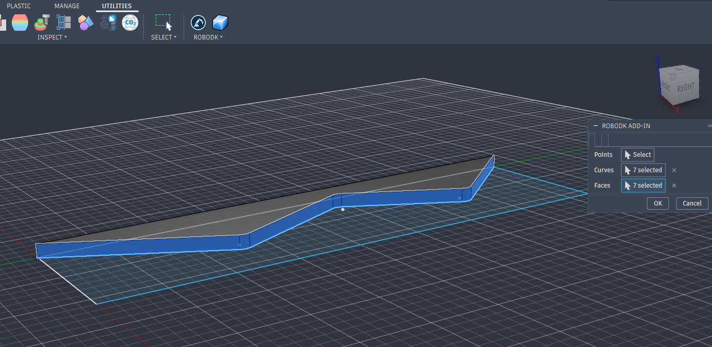

Thank you for the detailed explanation.
It is possible to simulate realistic AGV movement in RoboDK. However, you will need to use a curve with normals defined relative to the corresponding vertical wall and rotate the tool accordingly. This will allow you to properly control the AGV's orientation (RZ). Additionally, the corners must be smoothed to ensure the AGV remains streamlined with the straight sections of the trajectory.
You can create this type of curve in CAD software and import it using one of our CAD/CAM plugins:
I have attached your station with this example added.
If you have specific requirements for the trajectory input, please contact us via email so we can discuss developing a specific add-in for AGV simulation.
