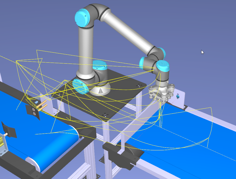

I have a problem with trace. I already tried to reset it and to unchecked it in the menu. I also tried to turn of display path at scripts but it just wont go away. Please help me.

Hi DKeretic,
Did you try simply saving your station, closing, and reopening RoboDK?
My colleague and I noticed what we think could be a little graphical bug yesterday on the latest version.
Let me know if it solves the problem.
If it's the case that would confirm our finding and we will fix that in the next few weeks.
if it does not fix the issue, make sure that all programs (main, subprograms, scripts) all have "Display path" unchecked.
Yes, I already figured it out and closing the station solved the problem.
Regards!
