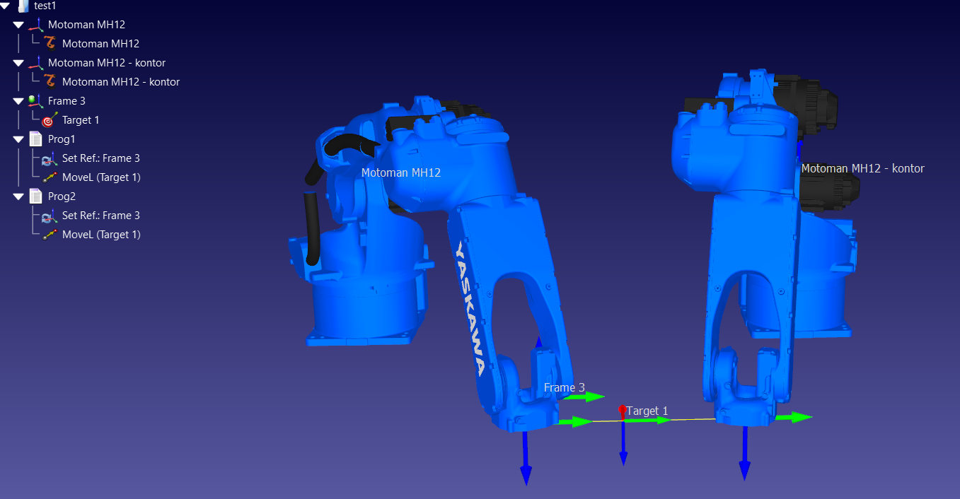

I have a setup with 2 robots. I create a reference frame and in that reference frame I create a target for the selected robot.
I create a simple program where the robot moves to that target.
I then want the other robot to move to the same target. I Link the target to the other robot and create another program.
I now have 2 program that makes each robot go to the same target.
Now when I generate the programs I would expect 2 different program. They are however exactly the same.
I think its really confusing that the simulation in the program does not corelate with the generated program. I guess I need to just make a target for each of the two robots?

You need 1 target per robot.
More details toward the end of this video: https://youtu.be/AIMM80yDKA0
