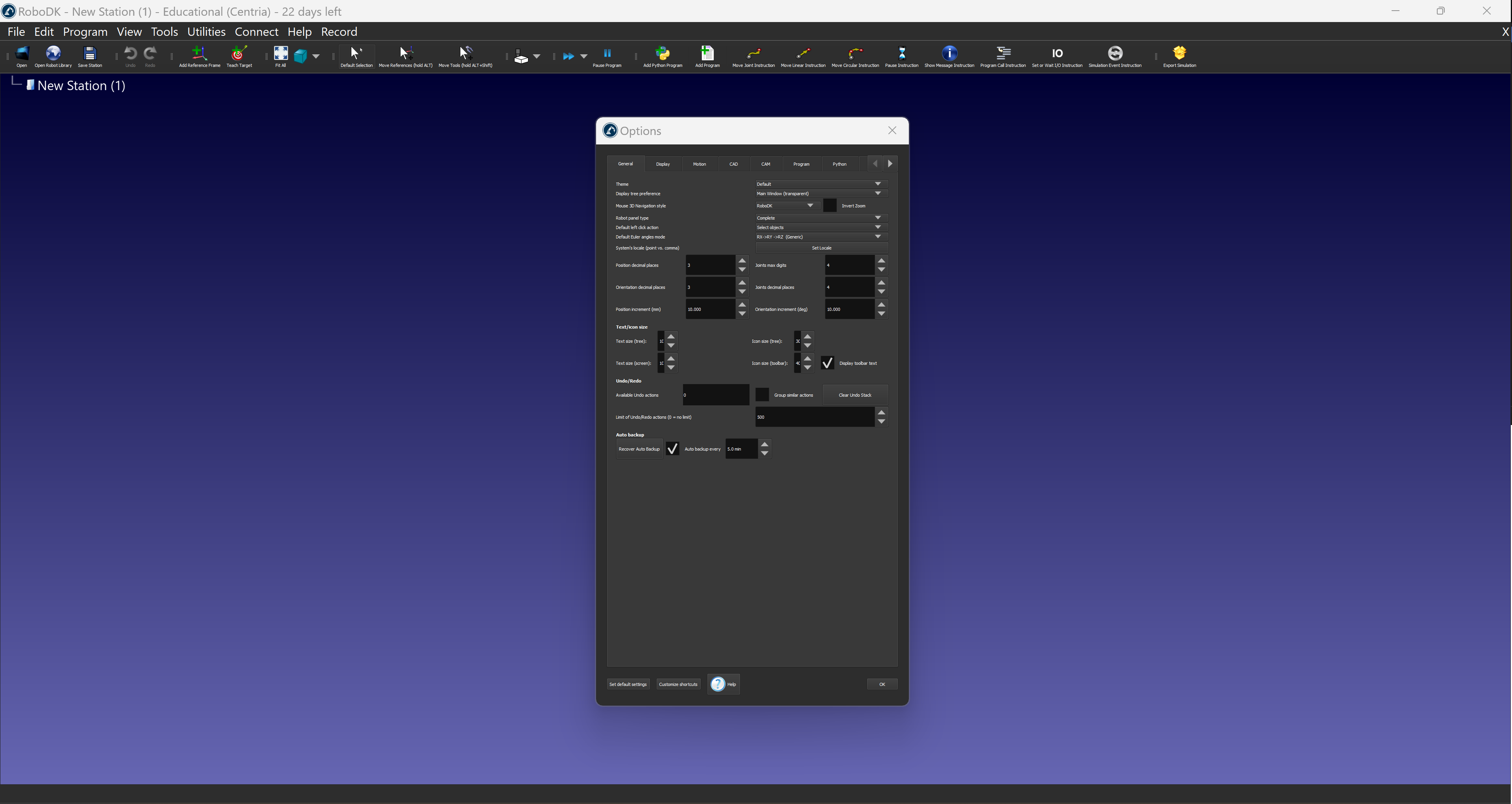

I discovered this annoyance while working home from my office. I normally use two external FullHD diplays when my laptop is connected to the docking station and no issues there. Now I am currently working at my home and I use the laptops' own 4K display and one external FullHD display.
While extending my desktop to both screens, the texts on toolbar and windows are so tiny I can barely see read them. If I switch to using only 4K screen or only FullHD screen, all texts and icons scale back to normally visible size (after restarting RoboDK).
If I switch from extended workspace to single screen while RoboDK is running and I hover the mouse over icons, RoboDK scales the texts but ends up either making the texts tiny again or enlarging them over their corresponding placeholders and thus clipping the text.
