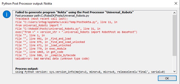

I need to modify the Universal Robots post-processor for UR5e.
Is it possible to add a default subprogram into the postprocessor? I've tried and it didn't work.
You see the error message in the attachment:
I can change the default values of subprograms. But if I add or change any line of Universal_Robots.pyc file process is crashing.
