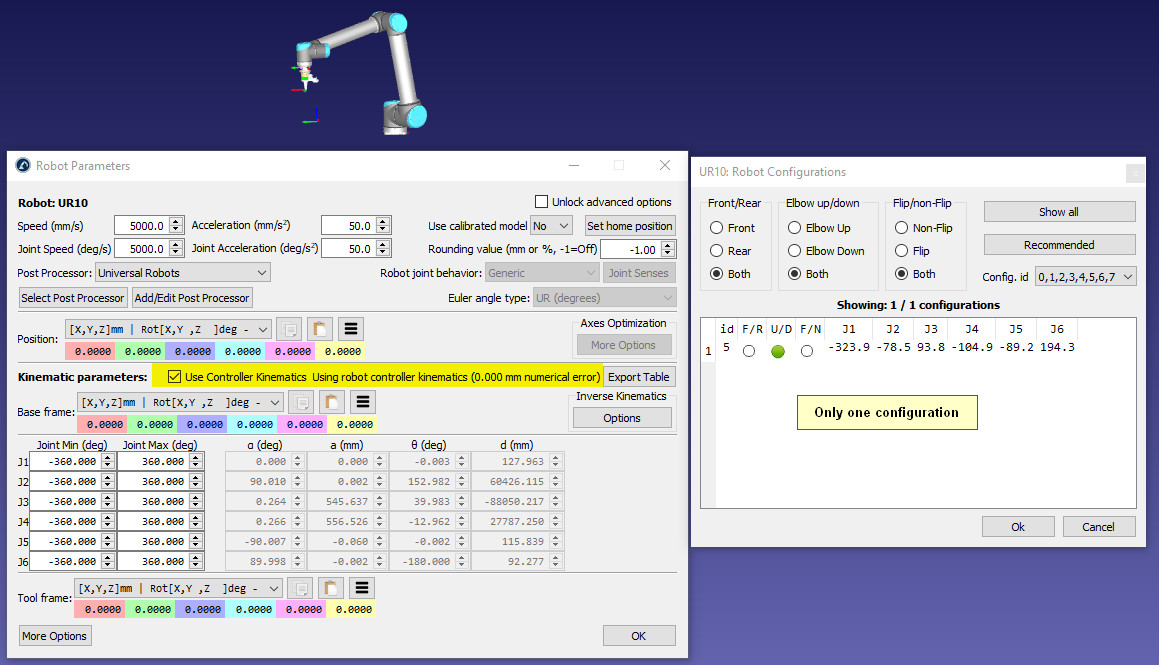

I use an UR10 and to get the same tcp values as the real robot (teach pendant), I used the script UR_LoadControllerKinematics.pt to import the Denavit Hartemberg parameters of the robot under robodk robot.
It works fine but I do not have the choice on robot configuration when the controller kinematic is enabled.
Is there a way to compute all the configuration possibilities with controller kinematics enabled ?
- controller kienmatics disabled
- controller kinematics enabled
Thanks for your support
Florent
