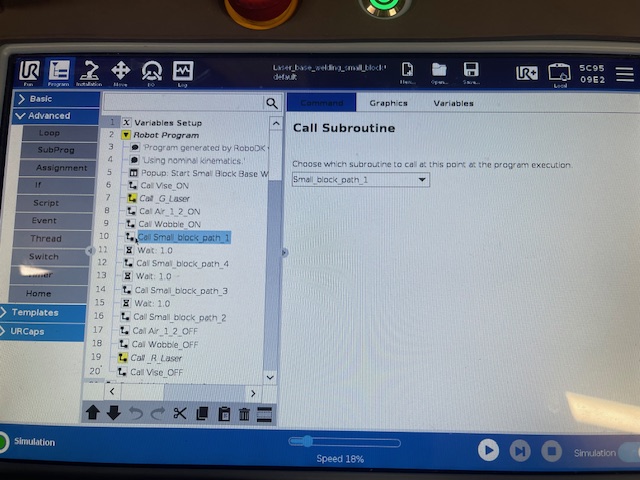

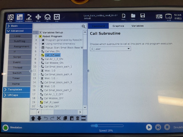

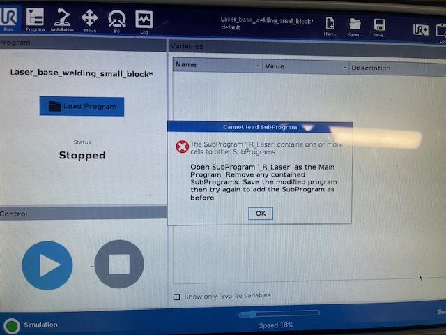

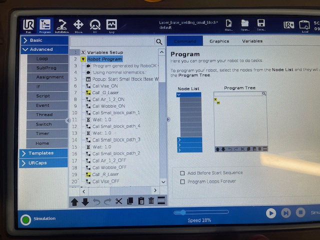

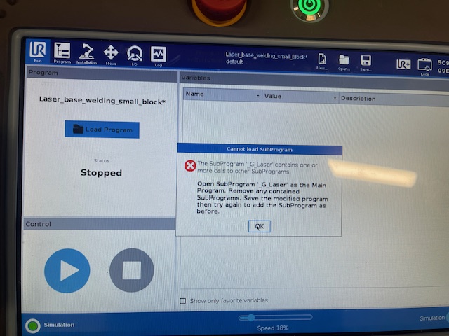

We get the exactly the same script file, it is with the .urp file that we get the errors, it posts fine into the robot via filezilla. Attached are the pictures of the error the UR is giving for the generated .urp file
