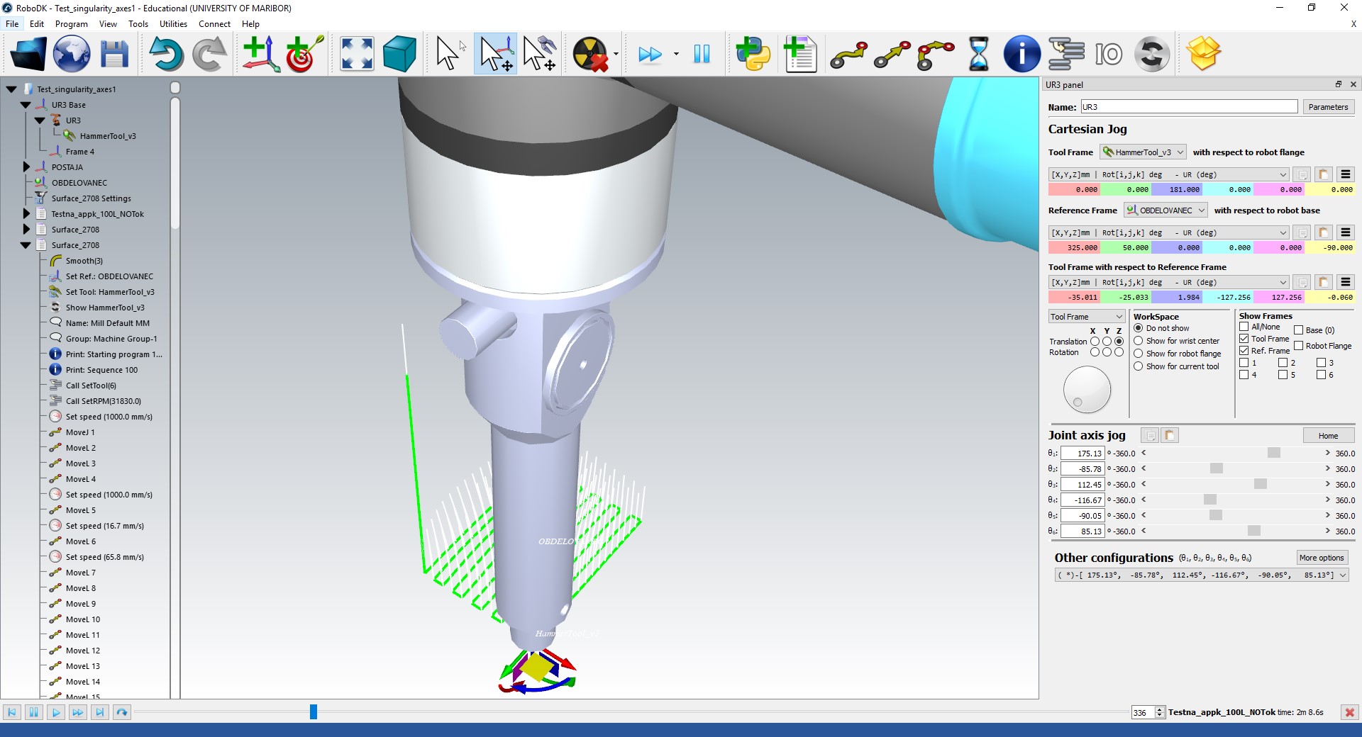

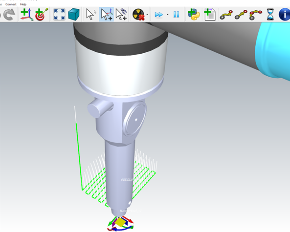

We use the MOVEP command to generate the robot program. In simulation in RoboDK everything is fine. However, when we transfer the program to the UR3 robot, the following problem occurs: '' moveP: Cannot move at the specified speed due to safety limits ''. We recorded the actual speeds (joints, TCP) and nowhere to see any of them exceed the limit. What else could affect this error?
Maybe just for information: if we use the '' moveL '' command, we don't have these problems. The speed of movement of the robot in both cases is 100 mm/s (TCP). Robot Trajectory is attached in the attachment.
Thanks for the help and best regards!
Mitja
