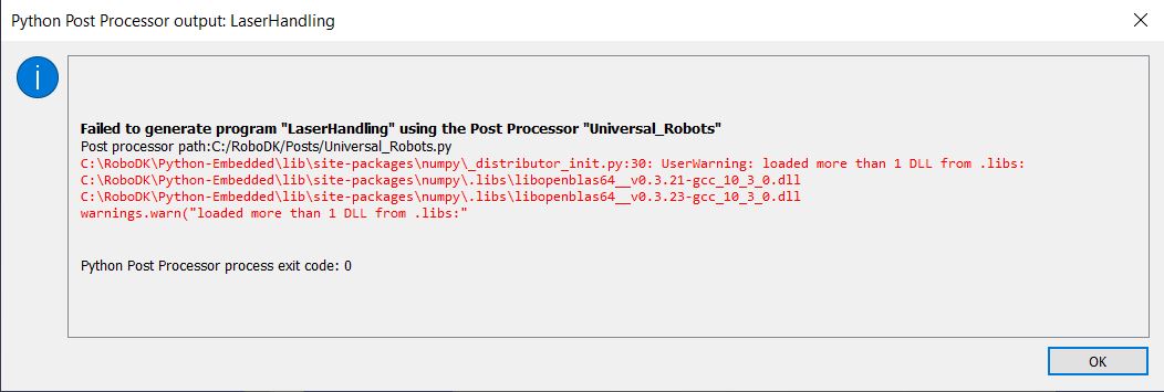

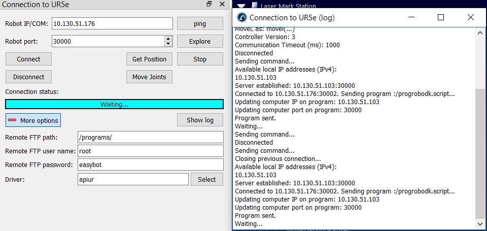

UR5e program generation & connection issue
Can anyone help with this error about Generating Robot program for a UR5e cobot. Also connection to Robot is always showing Waiting status
Can you update RoboDK to the latest version and try again?
You don't need to uninstall RoboDK but you should make sure RoboDK and all processes started by RoboDK (including drivers) are stopped before reinstalling.
Let us know if this issue persists.
