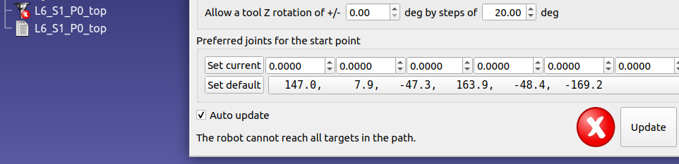

We are using the Python API to create a Curve Follow Project in RoboDK, to then generate a Robot Program. However, at some points in the generated robot path, the robot reaches a singularity and stops. This is shown in the RoboDK UI by the red X mark on the Curve and by the message "The robot can not reach all targets in the path" (see attached screenshot). How do I check if this error happened using the Python API?
