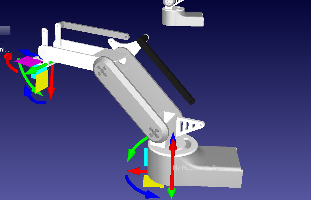

Respected RoboDK Team,

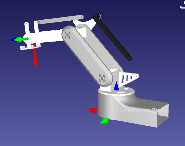

I am currently developing a custom robotic arm that I would like to simulate in RoboDK. As shown in the attached images, the joints and mesh appear to be correctly defined. However, I am facing challenges in replicating the 4-bar linkage mechanism.
Specifically, the rear link should be constrained to move like a 4-linkage bar system (similar to the ABB IRB 760). I am unsure how to properly lock the links at the base and at the triangular section so that the mechanism behaves as intended during motion.

summery : the support link at the back does not attach to the base like the one in abb robot does

You can try synchronizing the positions of the links using a Python script.
The script uses the RoboDK API to change the position of the mechanisms corresponding to the links according to the position of the robot.
I attached an example.
.rdk   BX300L_v3.rdk (Size: 2.34 MB / Downloads: 344)
