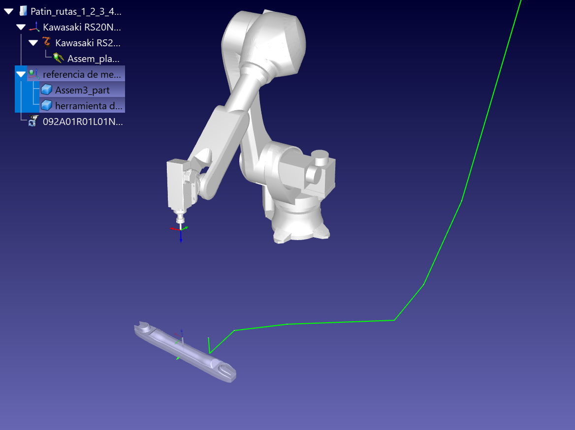

I have a problem when traying to run the utility "Robot milling project", with a G-code file as an input.
It appears the corresponding tool path in the screen with a long line that seems to go to or come from the
infinite.
A message on the screen : " unable to find a starting point ", so I can´t continue.

It is important to say that the same project runs perfectly wit a demo of RoboDK
Would anybody hepl me ?
I attach a few files that can be useful to understand the problem.

Hi Jaisa,
Can you join the G-Code you imported? Seems like the first point was weirdly imported.
Which CAM program did you use to create it?
.zip   Ruta_1.zip (Size: 27.13 KB / Downloads: 1,170)
This is the G-code I wanted to import.
The  program used to generate the G-code  was Powermill
