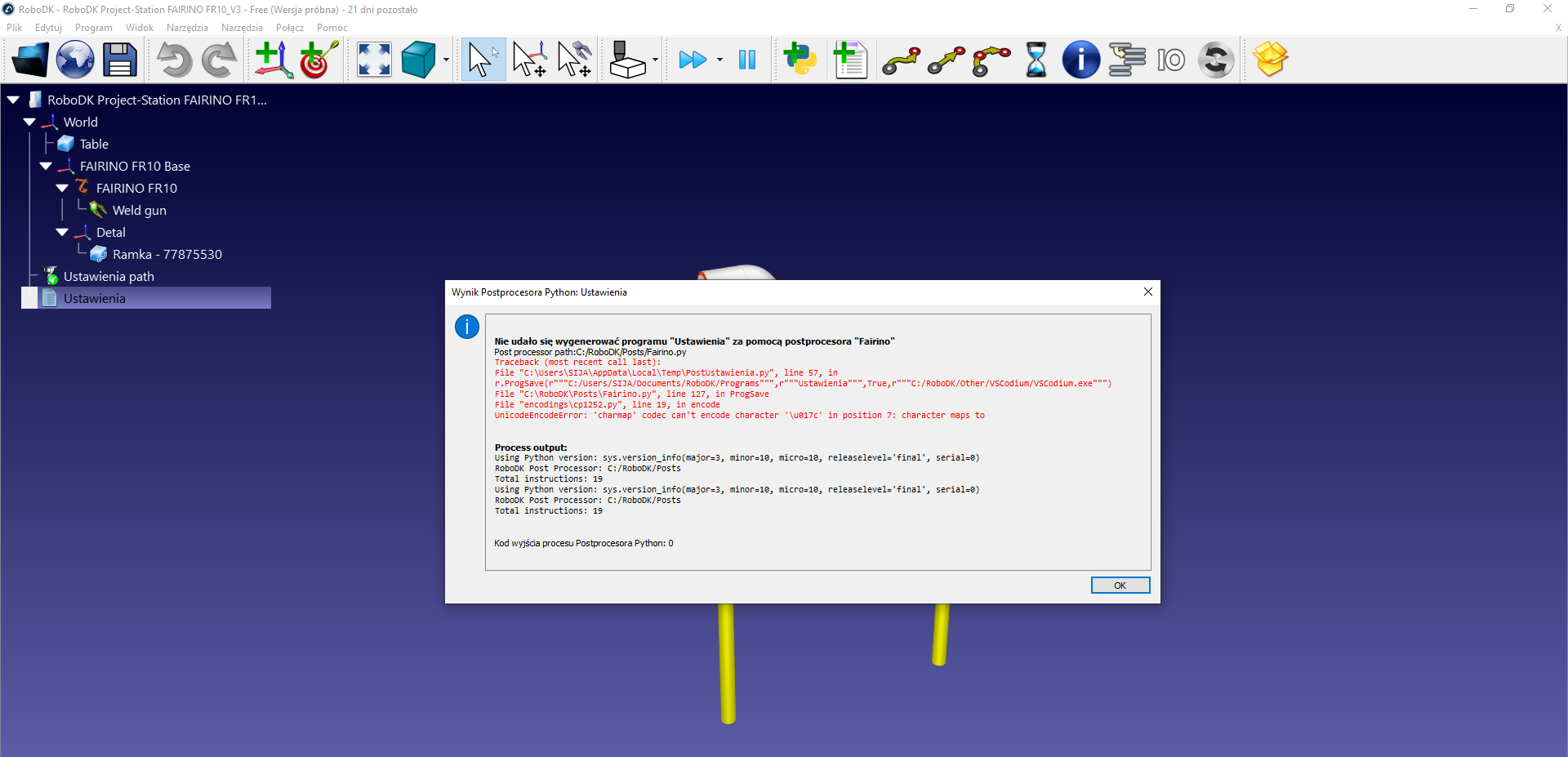

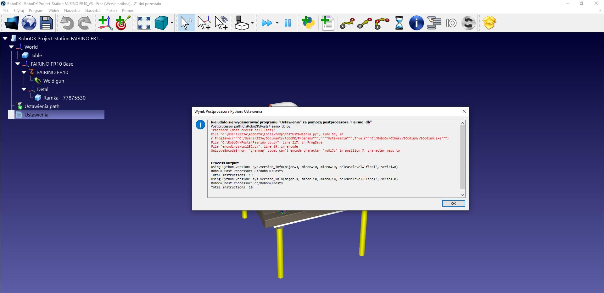

I'm encountering the following error when generating a program in RoboDK (v5.9.2) using the
Fairino.py
post processor:
vbnet
KopiujEdytuj
UnicodeEncodeError: 'charmap' codec can't encode character '\u017c' in position X: character maps to <undefined>
Could you please help me understand the cause of this issue and how to resolve it?
Thank you in advance for your support.

(08-03-2025, 06:31 PM)Albert Wrote: You probably have some special characters when generating the robot program. We'll fix the post processor.
Can you share your project file? We need to reproduce this issue to properly fix it
I'm sending the file for analysis. I suspect it's Polish characters (I've removed all visible user-level characters). Please fix the fairino.py and fairino_db.py postprocessors or suggest a way to bypass this problem.
