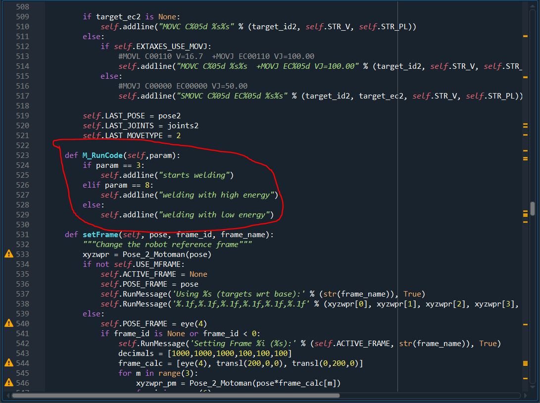

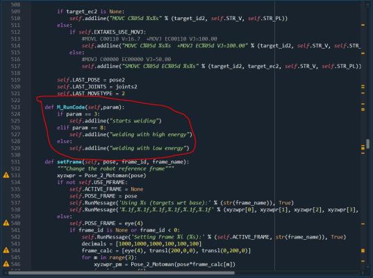

I’m actually trying to modify the postprocessor Motoman by integrating an M_RunCode(n) method, but for the moment nothing is displayed in the robot code. You can see in the attachment what I did now. For the moment I’m displaying commentaries in order to understand the code of the postprocessor.

Bonjour Max,
In fact, you should do the change in "def RunCode" section of the post-processor.
It should look a bit like that:
def RunCode(self, code, is_function_call = False):
       """Adds code or a function call"""
      if is_function_call:
           if code.lower().startswith("m_runcode"):
               if not code.endswith(')'):
                   code = code + ')'
               if code[10] = "1":
                   #addline to activate your thing
               elif code[10] = "2":
                  #addline to activate other thing
               return
Bonne fin de journée.
