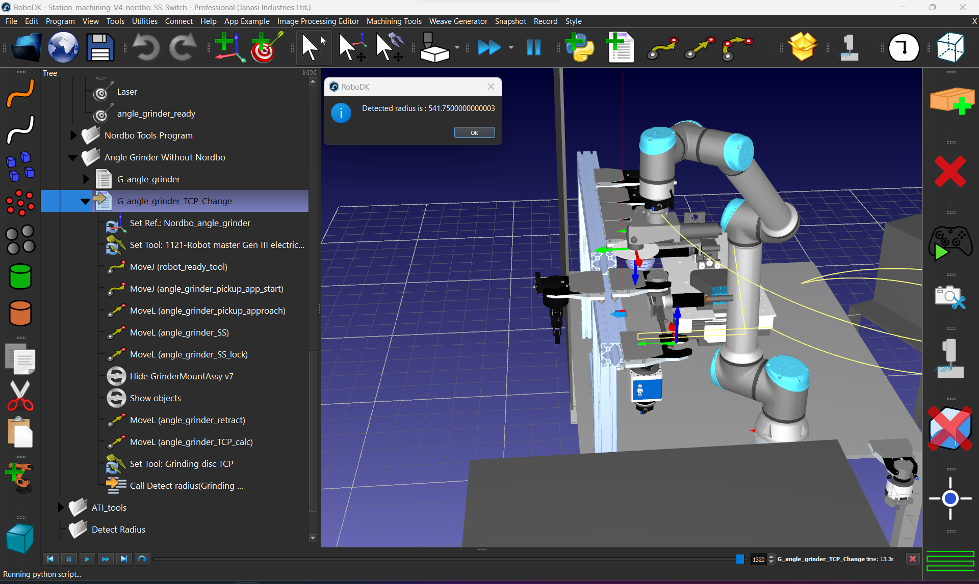

Thank you for the response. I tried adding the TCP change program into my workstation. But for some reason the calculated TCP is too  big. Like the grinding disc i have given in my station in R-63.5mm but when i run the program it shows 554.0000001mm. I have attached a screenshot of the output it shows in my station and also the station itself. Please have a look at it and suggest some solution.
.rdk   Station_machining_V4_nordbo_SS_Switch.rdk (Size: 14.1 MB / Downloads: 706)
