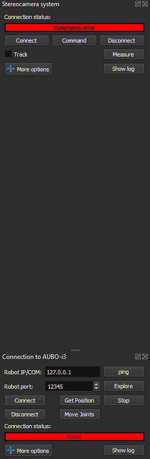

I have installed TwinTrack, when I try to connect the measurement system, I get the VXelements error. I couldn't understand what to do. It would be nice if someone who has dealt with this before can help.
Starting VXelements...
Trying to connect...
Working...
Failed to connect to VXelements
Retrying...
Working...
Retrying...
Working...
Retrying...
Working...
COULD NOT CONNECT TO VXelements
Tracking is not supported (probably invalid license)
ERROR: the CTRACK will not work
VXelements error
As the error message suggests:
You should contact Creaform to include the VxTrack license with Creaform VxElements.
